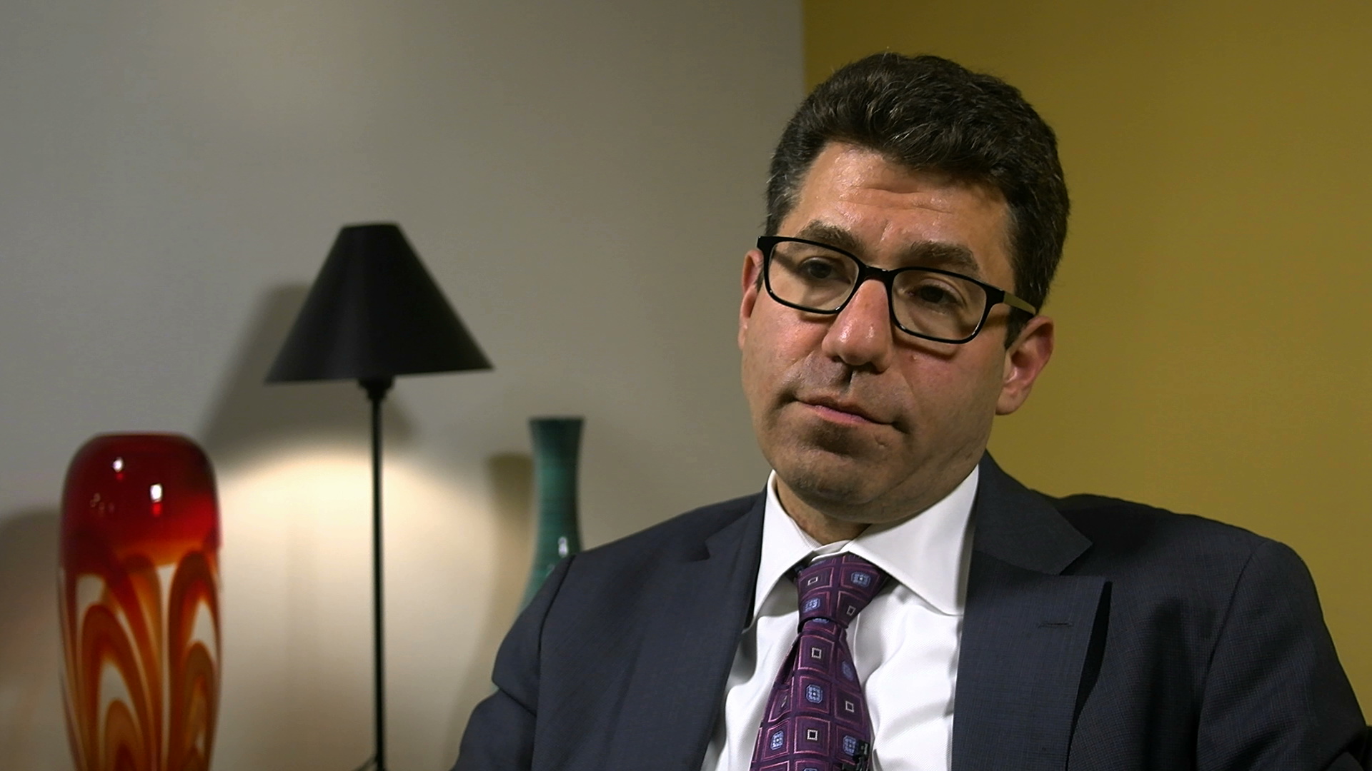

Included is a still from an interview I filmed yesterday. No CC yet, 20mm Lumix lens, f1.4, zoomed in a bit with Virtual Zoom, camera was set to Rec709. The tiny, tiny room had a large table between me and the subject so I didn't get the DOF I wanted and he had to leave quickly. The background, lights, sound and camera were set up by me alone in less than 15 minutes.

BTW William that setup looks very nice on that screen grab. Nicely done!

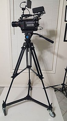

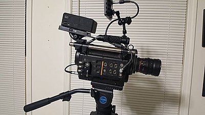

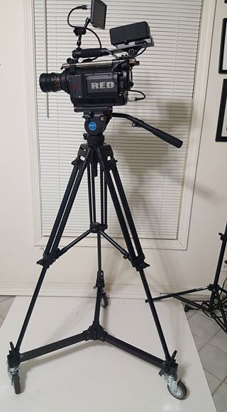

Well, to confirm my enthusiasm for this camera I just got a second LS300 on eBay for $1850 ilisted in pristine condituon with 3 large batteries and a double charger. Im super pleased! Just need to figure out my Red One Camera issue.
Aaron Jones Sr. is offline   Reply With Quote
Old May 19th, 2017, 02:45 PM   #8
Join Date: Jan 2017
Location: New York, NY
Posts: 19
Re: My First Impression of JVC GY-LS300
Will you sell the Red and if so for how much?
Courtney Baynes is offline   Reply With Quote
Old May 19th, 2017, 04:07 PM   #9
Join Date: May 2013
Location: Flint, Michigan, USA
Posts: 394
I would sell the Red for what I paid for it.
Red One MX - $3500
Red 640gb Hard Drive - $350
Benro H8 Tripod & Heavy Duty Dolly Wheels - $425
Note: The Spreader on the tripod does not lock in place and that is why I got it so cheap. it is actually a $800 tripod used and $1100 New
I would let it all go for $4000
* Red One Mysterium 4.5K Camera
* Red One 640gb Hard Drive W/ Red Hard Drive Cable
* Red One 5" Monitor W/ Red Monitor Cable
* Red One Rail Bottom & Top Receiver
* Red One V-mount Battery Plate W/ Red Power Cable
* 4 - 19mm Stainless Steel Rail Rods
* 3 - Pro-X XP-L95RED V-mount Batteries
* Sony V-mount 4 bay Battery Charger
My First Impression of JVC GY-LS300-18447017_1908543976082630_224046509698524883_n.jpg   My First Impression of JVC GY-LS300-18527614_1908543962749298_2536518457168806336_n.jpg
My First Impression of JVC GY-LS300-18485688_1908544082749286_275302841509217320_n.jpg   My First Impression of JVC GY-LS300-18519791_1908544052749289_1711020297806477858_n.jpg
My First Impression of JVC GY-LS300-18519894_1908544019415959_8000465103742499773_n.jpg   My First Impression of JVC GY-LS300-18485365_1908543999415961_4308558620601142901_n.jpg
My First Impression of JVC GY-LS300-18556330_1908544109415950_1158413833412044307_n.jpg
