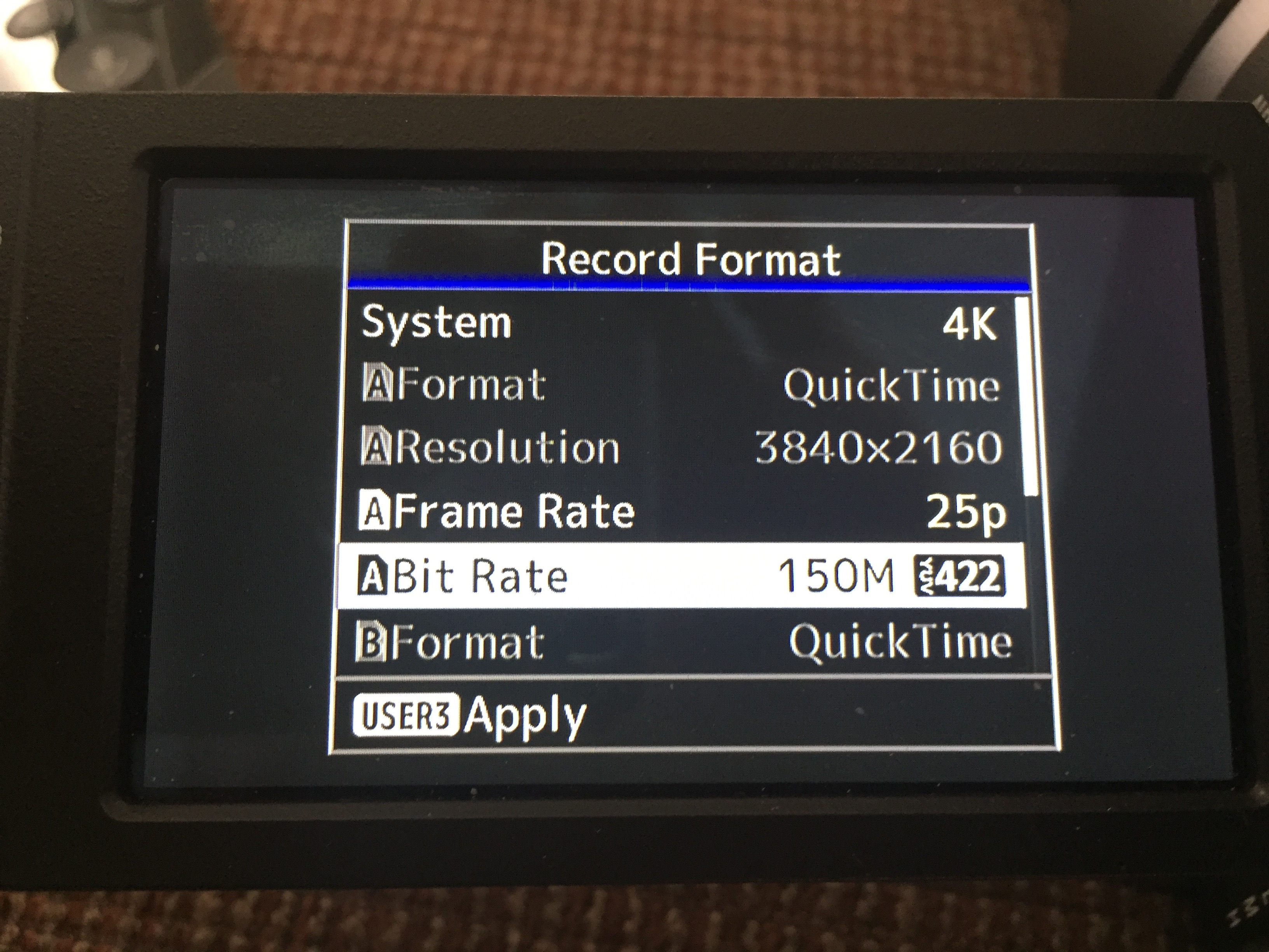

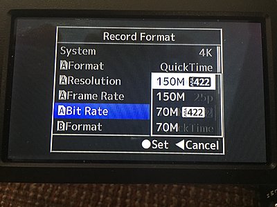

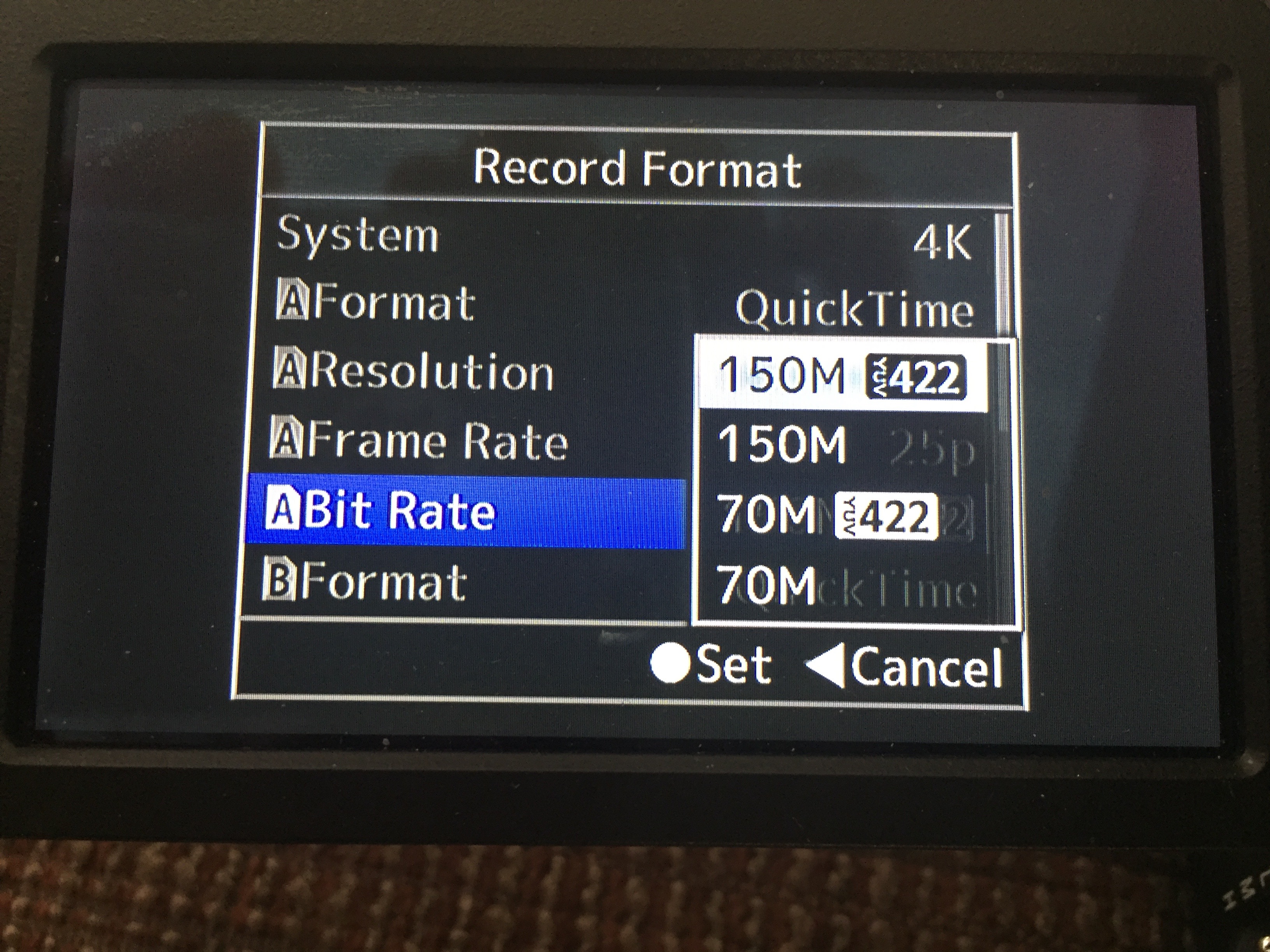

Hey Steve,
The option is under 'Bit Rate' and if you've got it selected, it's hard to miss :)

Nick: I finally figured that out - for some reason the bit rate drop down box was greyed out the first time I tried, but after rebooting the camera a second time it appeared - and, yes, 422 was not selected by default, so it's a good thing I didn't assume it would be.
