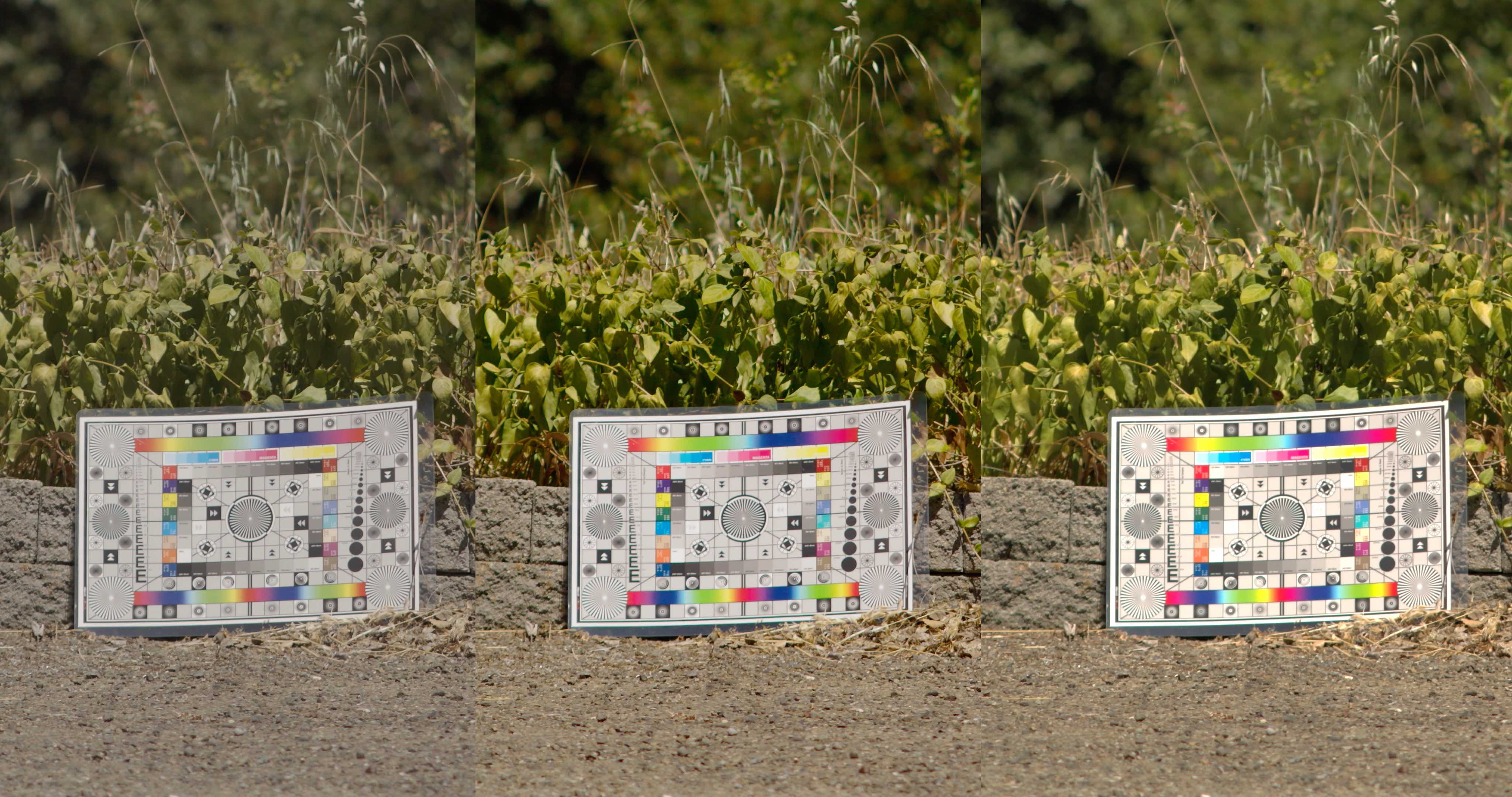

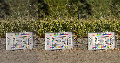

Here is a quickie sample to go with my info above. These are 3 segments from a few seconds apart. First on the left was the J-Log as it comes off the camera.. the middle section is the J-Log footage with the stock JVC LUT applied, and the final section on the right is the JVC Cinema Gama with the 709 color matrix. Very similar, though there is some color blooming and the middle grey has less variation and less subtle variations as the JLOG. For fast turn around time you could still shoot J-LOG apply the JVC LUT and export out the footage or just shoot Cinema Gama with 709 color matrix and any changes you like on the fly for something almost as good for a quick job. Hope that helps.
