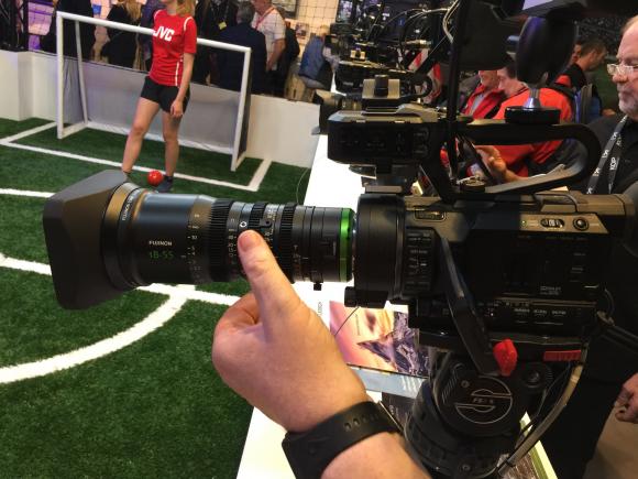

At IBC 2107, MTF Services showed their mft (micro 4/3) conversion mounts for Fujinon's MK-series of Cine zoom lens (18-55mm and 50-135mm). I've attached a picture of an LS-300 with the18-55mm from IBC 2017 that was posted in the comments of a related story at Newsshooter.com
The lenses are designed to cover S35 sensors on Sony E-mount cameras and I'm curious to know if they cover the LS-300 S35 sensor at 100% VSM on the wide end (18mm). The Veydra 16mm falls just short but a couple more millimeters might just be enough. The 18-55mm has a slightly larger range than 4 Veydra's primes (16, 25, 35, 50) so it's an interesting alternative for a couple hundred $$ more after the mount conversion.
Hoping someone from JVC is on the forum and can provide a definitive answer about the sensor coverage.

The information from Fujinon we received is that the lens covers 28.5mm, which is wider than both APS-C and S35 measurements on record. Combined with the comment from MTF Services in their YouTube video about their adapter mounting the lens at the same focal length, the GY-LS300 imager should be able to capture a clean image at 100%, in theory.
Not having attended IBC 2017 I cannot confirm or deny this, but the reports are promising. Hopefully we will have the opportunity to test the lens and the adapter for ourselves in the very near future. It goes without saying that both Fujinon and MTF Services are great companies with great products.

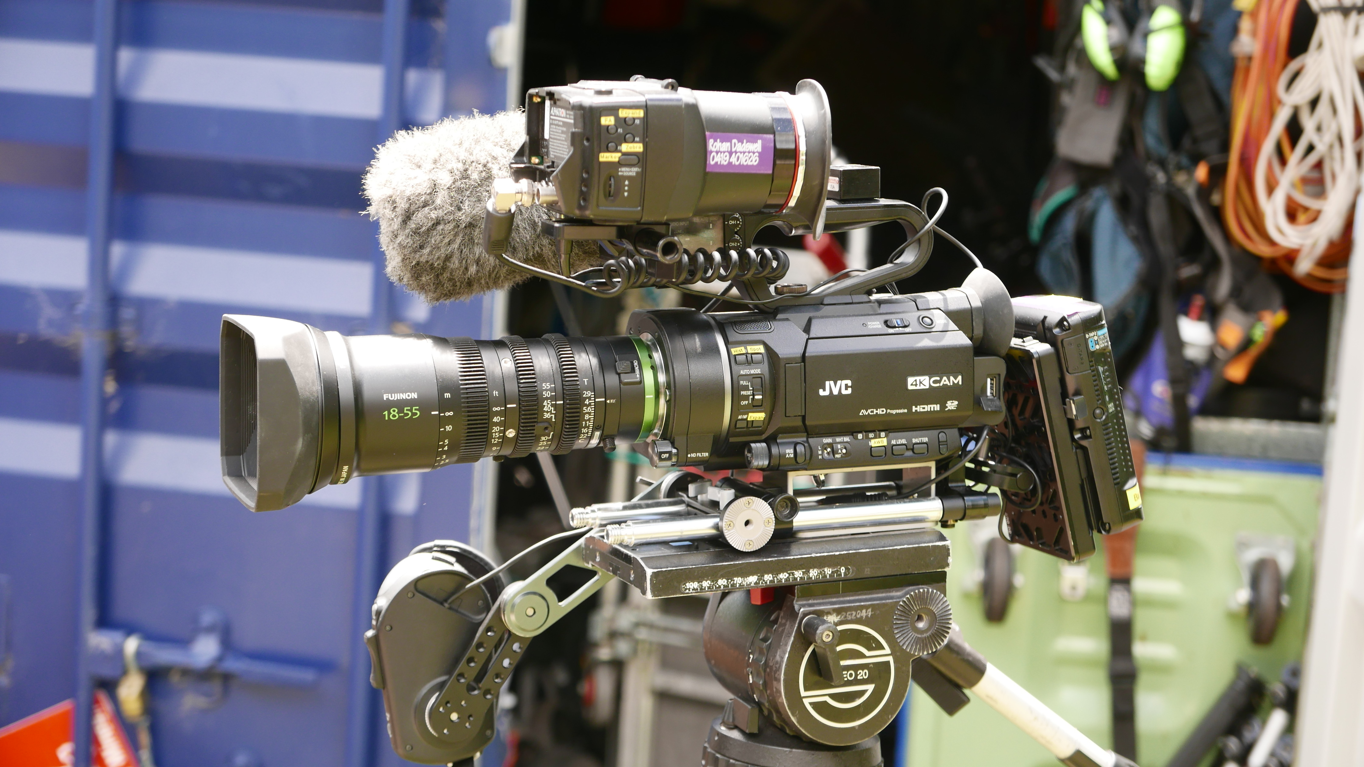

No problem with full sensor coverage with the 18-55mm - it's a great combo

Very nice. Since the lens weighs more than the LS-300 lens mount limit of 0.85 kg you might consider a lens support.

Is it parfocal on the LS300? I have several legacy S16 zooms that aren't (even though they are on other cameras like the BM Pocket and Micro)...

Yes, it is parfocal - once you adjust the back focus, which is very quick & easy to do thanks to the broadcast style adjustment ring. No mucking about with shims.
I have noticed that I need to change backfocus if I use this lens on the GH5 or pocket camera - they are all slightly different.

What adapter E to MFT are you using?
Also, I see you aren't using support. I have my LS set up for shoulder use, and don't want rails. Can I get away without lens support?

It's not actually an adapter - you replace the E mount with a M4/3 one (4 screws) from MTF Services in the UK.
I do use a lens support if I'm running around but not so much for corporate tripod work. The lens is over the recommended unsupported weight for the mount (just) - it feels solid but if it fails it will fail big time.
