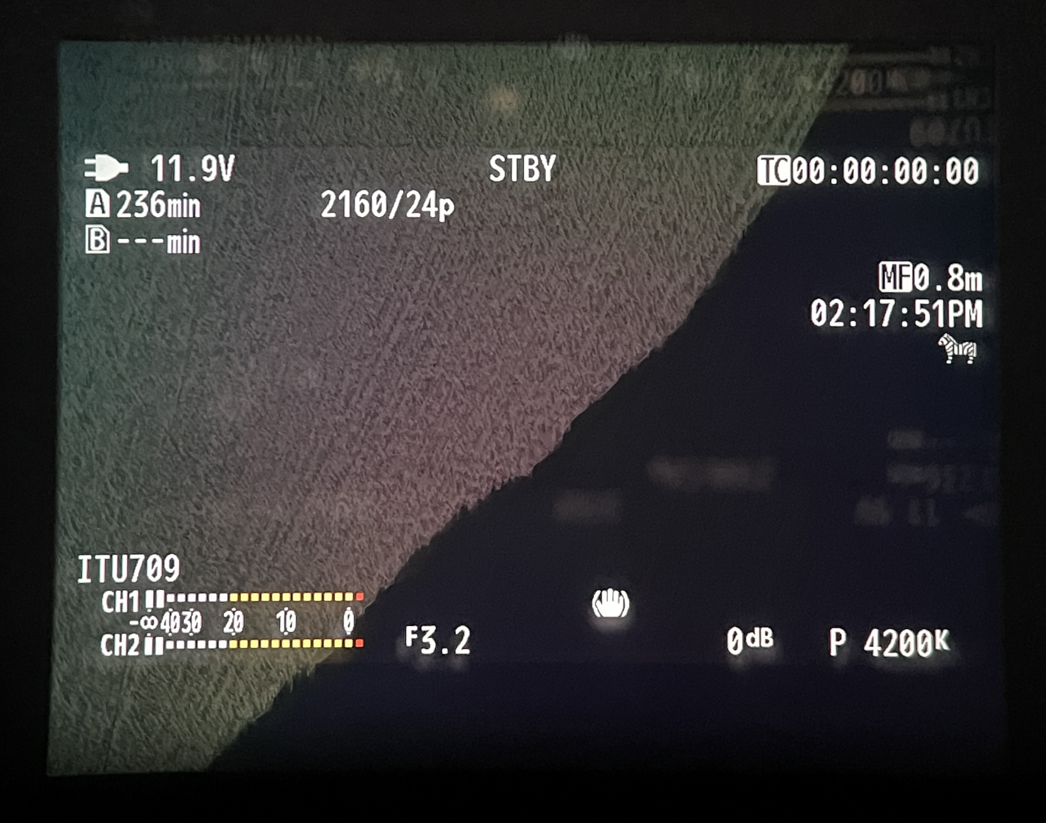

I got a GY-HC500U for myself this past September, and it has now developed a problem in the rear viewfinder. There's a diagonal haze over the top-left half of the screen. (See attachment; shot with iPhone through viewfinder.) Has anyone seen anything like this before? Needless to say, I'm attempting to get in touch with JVC Canada about getting it serviced.

Mark the problem edge with a removable pen to see if it’s getting any worse.
It’s not from weather condensation in your area is it? You could try satchels of desiccant in the camera bag, to try drying it out. I wouldn’t put any heat on it.
JVC probably won’t look at it when you deliver it but if they tell you the problem is moisture, the viewfinder might need replacing and it’ll probably be elsewhere in the camera, so ask them to check inside for that and take pictures, if they find any.

That's the thing, there's no easy way to get into the viewfinder. The lens itself is sealed, not removable like a typical larger viewfinder. The enclosure is pretty much a solid tube. There's a knurled ring next to the rubber eyepiece, but that's purely decorative, molded directly into the plastic. The only openings are a slot for the focus adjustment at the bottom of that knurled ring, and a small hatch with screws below the hinge. There's definitely no way moisture could have dripped in from above. It either had to have been in there already (lubricant, perhaps?), leaked around the lens seal, or came in as humidity from below. I haven't used the camera in any wet environment. I've barely used it at all besides testing it in my office.
I can probably monitor any changes by taking more pictures over the next few days and layering them up in Photoshop.

Sorry, I meant get removable marking pen, and mark the outside edge of the problem on the front face of the viewfinder Earl, just a few spots should do it. And I was thinking of humid conditions in your local area, eg: outside cold with heaters in your office?
However from what you now say it does sound like some form of leak, over the next few days or so, if the problem edge is expanding, try leaving the camera on its side, upright, face down etc. to see if it is a leak. And try Googling for similar problems, the more you can tell JVC when you take it in, usually the more co-operation you’ll get.

Leaving aside the bun fight over who's responsibility it is to remedy this situation, if remedy is indeed required, may I skip straight to the screen shot that was attached to the first post?
The viewfinder, although not pristine "as new", appears, for the time being, to be fully functional in that it is still indicating correct data across its entire area (Do let us know if that is NOT the case). That of course MAY change in the future.
Without knowing what production pressures are in play to get paying content from this tool (if any), may I suggest that you, Earl, leave the da*n thing alone, acquire said "content", pursue said "bun fight" and get it fixed at YOUR convenience as and when the time is appropriate and a "fixer" has been identified.
On the other hand, if the viewfinder continues to provide full functionality (assuming it is) despite its lack of sartorial elegance, you may of course decide to adopt a "if it ain't broke, don't fix it" approach, in which case, what's the problem?

Fortunately, JVC Canada replied the next business day and recommended I take it to their authorized service provider in Richmond, BC. The fellow there was even expecting my call! I took it there personally, and he seems to think the LCoS display has become delaminated. Just waiting now to find out if he can get the part.

Originally Posted by Chris Soucy View Post
The viewfinder, although not pristine "as new", appears, for the time being, to be fully functional...
You are correct. The display still functions and generates an image. It's just hard to judge exposure when that haze covers a dark scene. If I absolutely had to suffer with it, I could, but I want to have it serviced while it's still under warranty. If any jobs come up in the meantime, I still have my URSA Mini 4K. (The GY-HC500U is meant to be my second, more portable, run-and-gun camera.)

So the latest update. The service provider has determined the viewfinder display module should be replaced. The normal supplier is back-ordered on the parts, but JVC Kenwood has put through an expedited order for them and is working on getting the camera serviced as soon as possible. I'm happy with this. Everyone's efforts have been exemplary.
