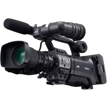

JVC GY-HM710U ProHD
A new camera came out, it is available in the US at B&H
Wow, do I like the look of that shoulder camera, wish I could try it out ....
I am not trying to make publicity, I just received an email from B&H telling me about it .

Here I got that picture

Too bad, it does not have 3 x 1/2 inch ccds instead of 3 1/3 inch ccds ? I guess it would be more expansive.

The JVC HM models from the 700, 750, 790 and now the 710 are all 1/3 inch. This came from the HD series. The 710 is the little brother of the 750 which is replacing the 700. The 710 has a few less features than the 750 but is a wonderful camera. There is nothing wrong with the image it or any of the HM7XX series produces and they all shoot both MOV or MXF.
Great camera for the money.

Thanks for the info, that is what I wanted, some people with the experience on those models .... for 6400 US$ it sure looks professional.
