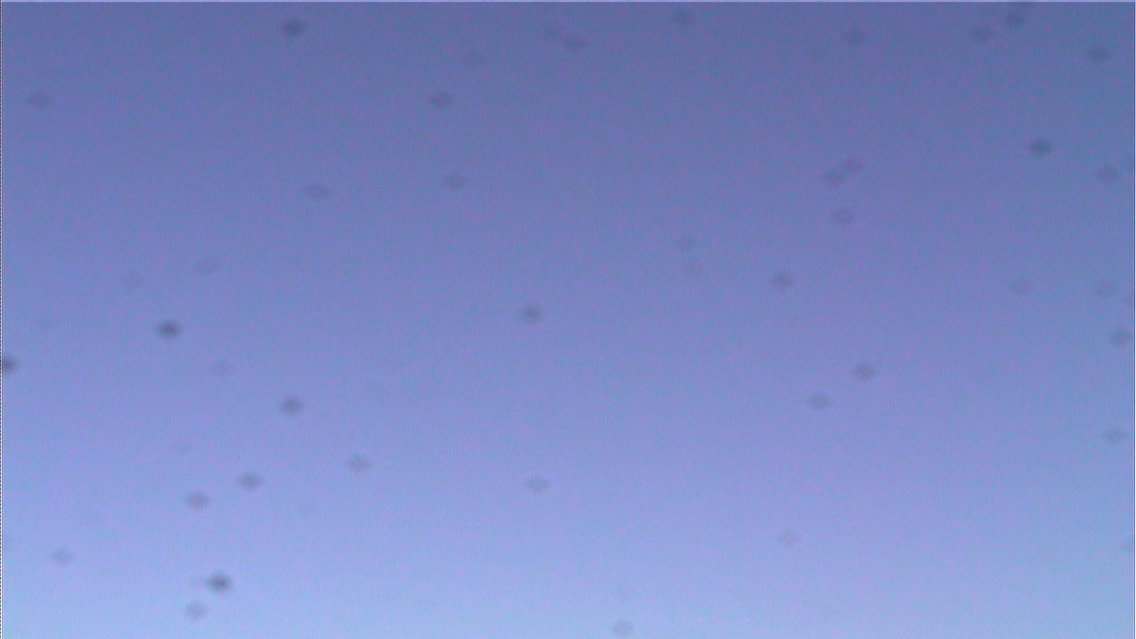

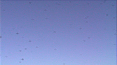

I am wondering, if this would fall under the jvc service issue that has been posted. It is showing this tendency whenever as in this picture the camera is pointed towards the sky.
I am really upset and bummed about this. This is the second unit I have had in less than 3 weeks, and now I am looking at probably another few weeks if I and my friend have to send it to JVC for repair or replacement. That "is" if the imager is defective like the report.
If anyone has any input, i would be most appreciative... Also, I did clean the main lens and there are no scratches or marks on it, so that isn't the issue.. I once again, thank anyone..

Judging by the same position in both samples I'd say that your CCD image sensor somehow got dirty. Did this just happen? Should show up on any lighter solid colored object so I'm confused by your saying it has a tendency to show up.
I'd say it needs cleaning but I'm confused since you tested the camera after you received it, didn't mention the problem then, and it's a sealed camera. If it were a D-SLR that you were changing the lenses in a dusty environment I could see it but not with a GR-HD1. Weird.
As for the service issue, this doesn't sound like it (but I've been wrong before):
"JVC has received reports that in certain circumstances, this model (GR-HD1US) may, while in the camera mode, show no picture, a distorted picture and/or display “LENS CAP” even though the lens cap is removed. We have identified the probable cause as a failure of the CCD image sensor."
http://www.jvcservice.com/service/cu...sp?ReqType=CCD
Good luck and let us know what you find out.

Hi Dave, yes, it is weird... And yes, it just showed up, or at least it just became noticeable. And it is happening on both mine and my friends units. Maybe it was a thing that it was there all along(unlikely) and we never noticed it, as the footage I took was outside this weekend and in a very bright envoirnment(it was a really nice two days). And yes, the ccd either being dirty or damaged(I thought damaged since when zoomed in and now, the little dots are perfect little squares and not say smudges) was what I thought, but we were and are both scratching our heads as to how it can happen on two cameras with non removeable lenses also..
Its very disturbing to me to be honest. And I am going to contact JVC tomorrow on the matter... But I will let you know for sure... It is just very disheartening...
Damon
That's very strange. Happening to one is odd, two is darn incredible. Were you both shooting someplace odd? Radioactive? Grabbed by aliens? :-)
If it's dirty sensors, that's a lot of dirt. They seem to be different densities, too.
Wild. Keep us informed.

Two cams with the same prob aims towards something that you both we doing, perhaps together. Shot directly into the sun? Placed cams near strong magnetic or electrical device? Subjected cams to extreem heat/cold (left them in a hot car)?
Are your cams very close in serial #? Maybe they are from a same bad batch.

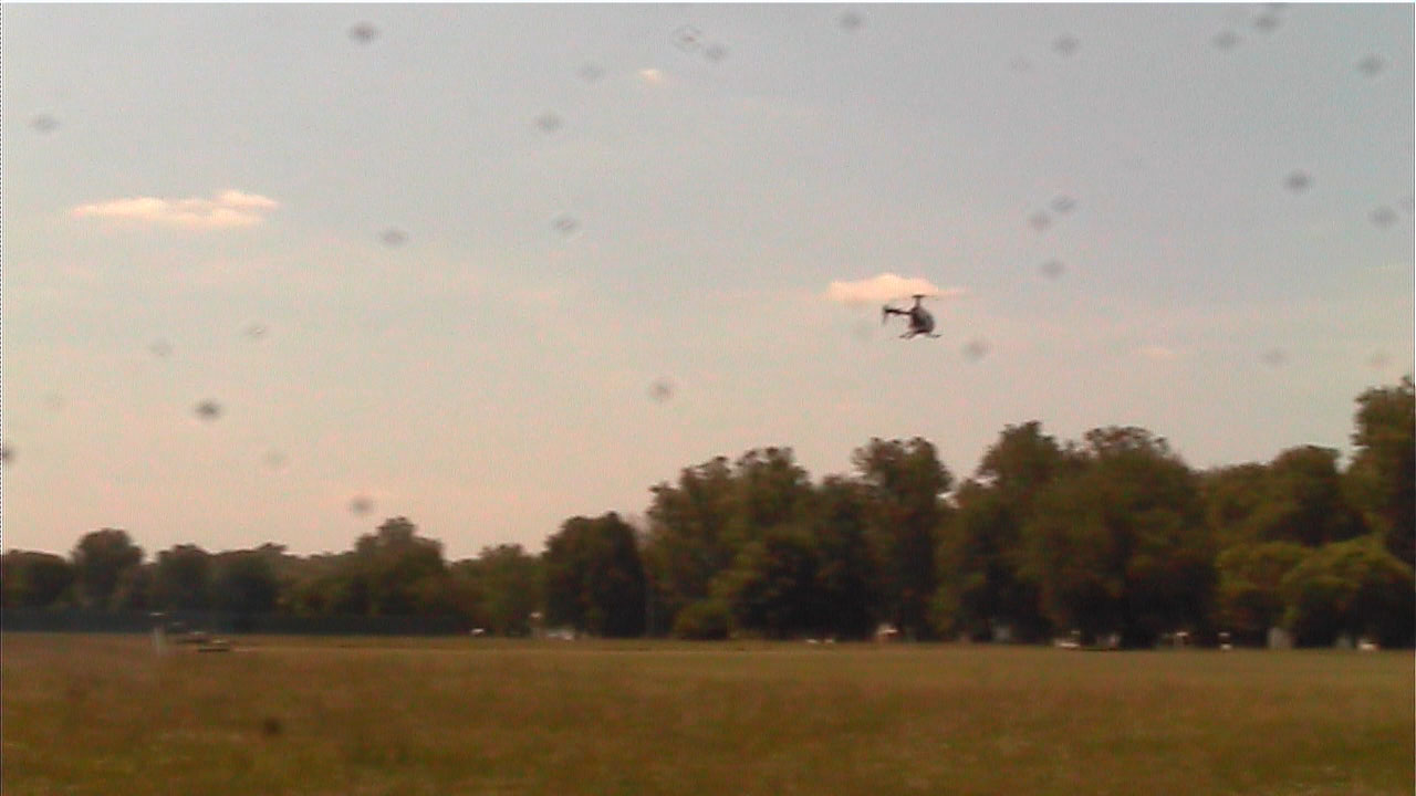

Well, we were shooting radio control helicopters flying. Something I have done countless times with my little and inexpensive TRV19.
And to be honest, we are both just tired of these cameras. These will be three in less than three weeks or should I say a month. We have sent for RMA's for them and I think we are going to go with the FX7's. She is going to get hers now, and I am getting mine in a few weeks. It just isn't reliable for us, and the negative experience. We both are just sort of burned out and tired... We will try the FX's and hopefully have better sucess... I will let you guys know in the next week...
