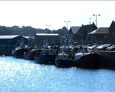

This is the shot in question:
balancing light/contrast-screen-grab.jpg
Connla Lyons is offline   Reply With Quote
If you could figure out a way to get more clouds in the sky this problem would go away.
