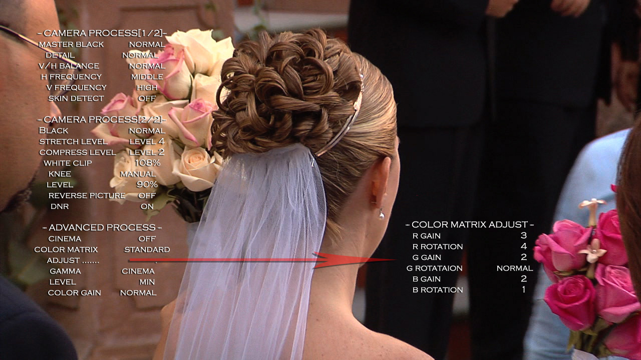

could you share your HD200 setup ? i see no grain at all in your pictures ! unbelievable ! mine are awful even at 0dB outdoor !!!

Hi Eric, all the shots I've taken here were at 0db gain. If I wasn't so timid around this cam I'd break that Gain switch off with a pair of pliers. It's only done me wrong so far, and I HAVE hit it by mistake. Attached here are the settings I used for the particular shots in this post. These are not exactly anyone's settings, but they are closest to Paulo Ciccone's True Color V-3.
Originally I shied away from the noise I was plagued with by doing a few different things - one of which was to reduce detail to minimum (as it's been suggested here). But doing that always kind of pissed me off because after all this is HD? I'm no scientist and the only degrees that I have make up my core temperature - so take my advice with a slice of pizza... But my shots turned around when I got better at setting my backfocus. I know, what the hell, right? I discovered it by jerking around in the back yard shooting flowers with the Macro all twisted. Flower shots looked incredible (no noise), but once I snapped it back into position the shots of our kid at the beach looked horrible (whole lot of noise) - both taken the same day.. So I went on a better-backfocus mission (monitor!) and all has changed since. Up until then all I use was the camera's lcd - not good enough for me, apparently.
The other strategy that I've adopted, which I hadn't before when I used to get the noise, (this could make absolutely no difference here what-so-ever) is the use of ND filters rather than higher shutter speeds.
Oh, and lastly, once I got released from Zoomaholics anonymous (been sober for a whole month now) my images look a lot cleaner as well. I don't go deeper than 65mm now. For instance, in the "Drums" pic attached here, I would have burned myself good on both the chrome and his white shirt against his black pants if I went deeper than 65mm.
I wish I could help you more Eric, but the rest is simply the JVC..

thanks Eric, i will start to check these settings ;-)
