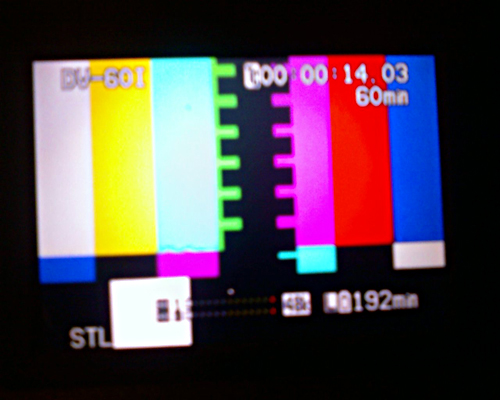

But today I arrived to an irate field crew. "Two days of shooting is ruined! " They tell me. "A black bar thingy is through all the footage!. But it doesn't show on the viewfinder."
Sure enough. It looks like a zipper vertically through the image on tape. We tried a cleaning tape and it has no effect on it. This is in DV mode. In HDV, the image just breaks up and flashes on and off.
I am attaching the image from my cellphone of the LCD showing the zipper effect. I've done this before but it dissapeared after a day or two so let me know if this thumbnail dissapears.
So much for using the camera out of the box. I learned my lesson, test everything before putting it into service. Now I at a loss of what my next move is.

Wow. Your next move should be this camera's immediate return to Lawrenceville and be sure to include the tape which shows this problem.

We finally got our HD250 back working, woo hoo. And the 2nd repair of the drum assembly only took 2 weeks!
So, apparently the zipper thing was the drum. But is says Error Rate Adjustment, Foreign Matter on the repair. I guess that means something was on the head or in the assembly? Weird.
