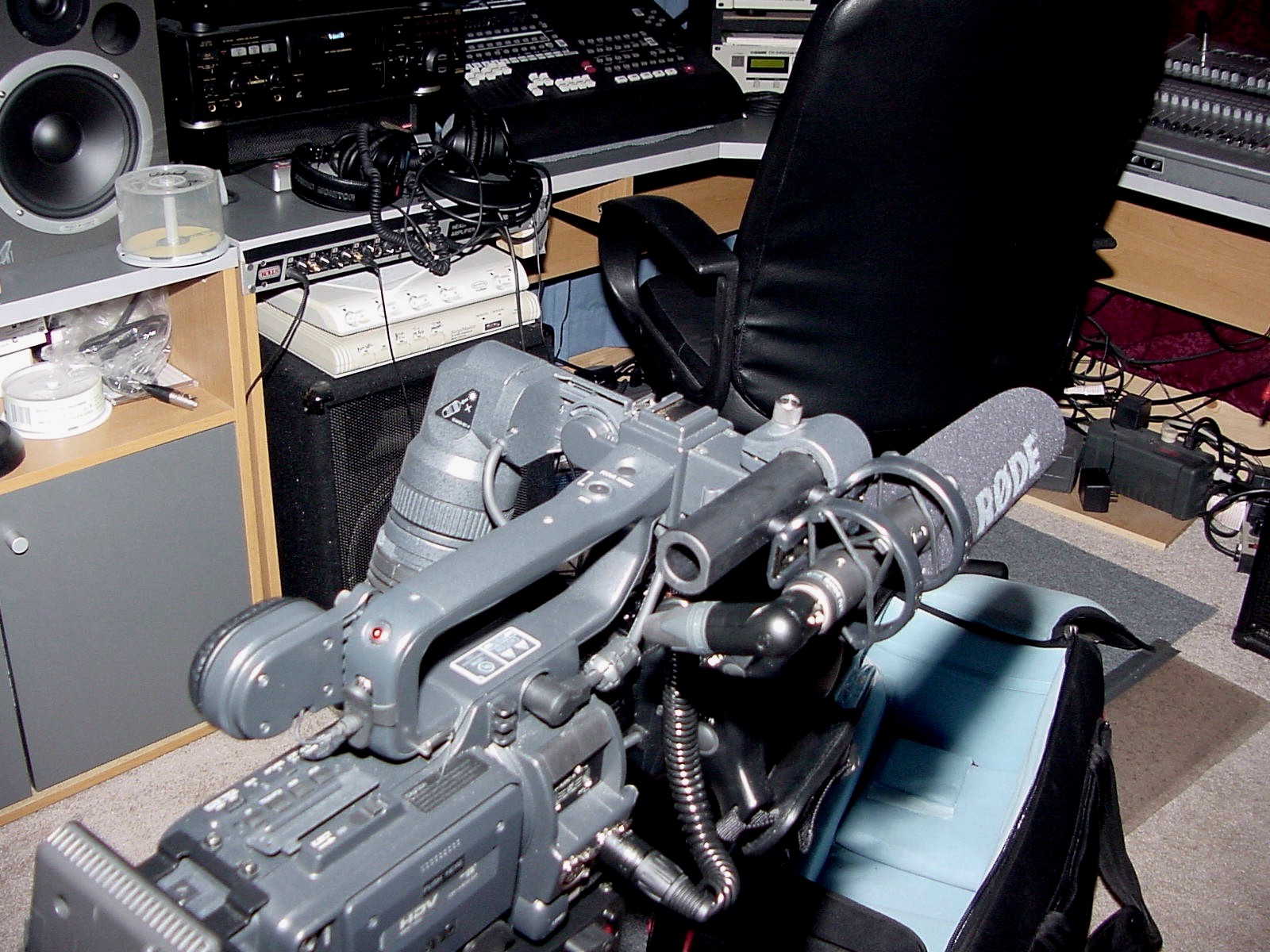

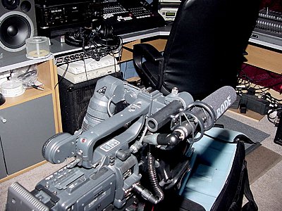

Old November 26th, 2007, 07:49 PM   #11
Location: Coconut Creek FL
Posts: 291
Hello
got the Rodes SM5 mic holder for my ntg-1
no more hum no more noise
check out the pictures
Its a tight fit on the mic clamp/ holder if i could get a bigger JVC clamp i would
but it works great
THANK YOU
Joe

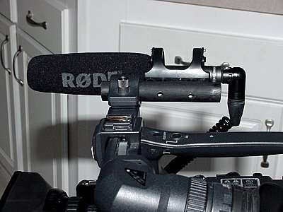

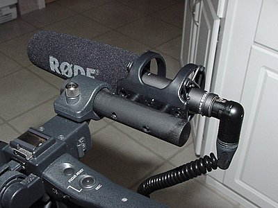

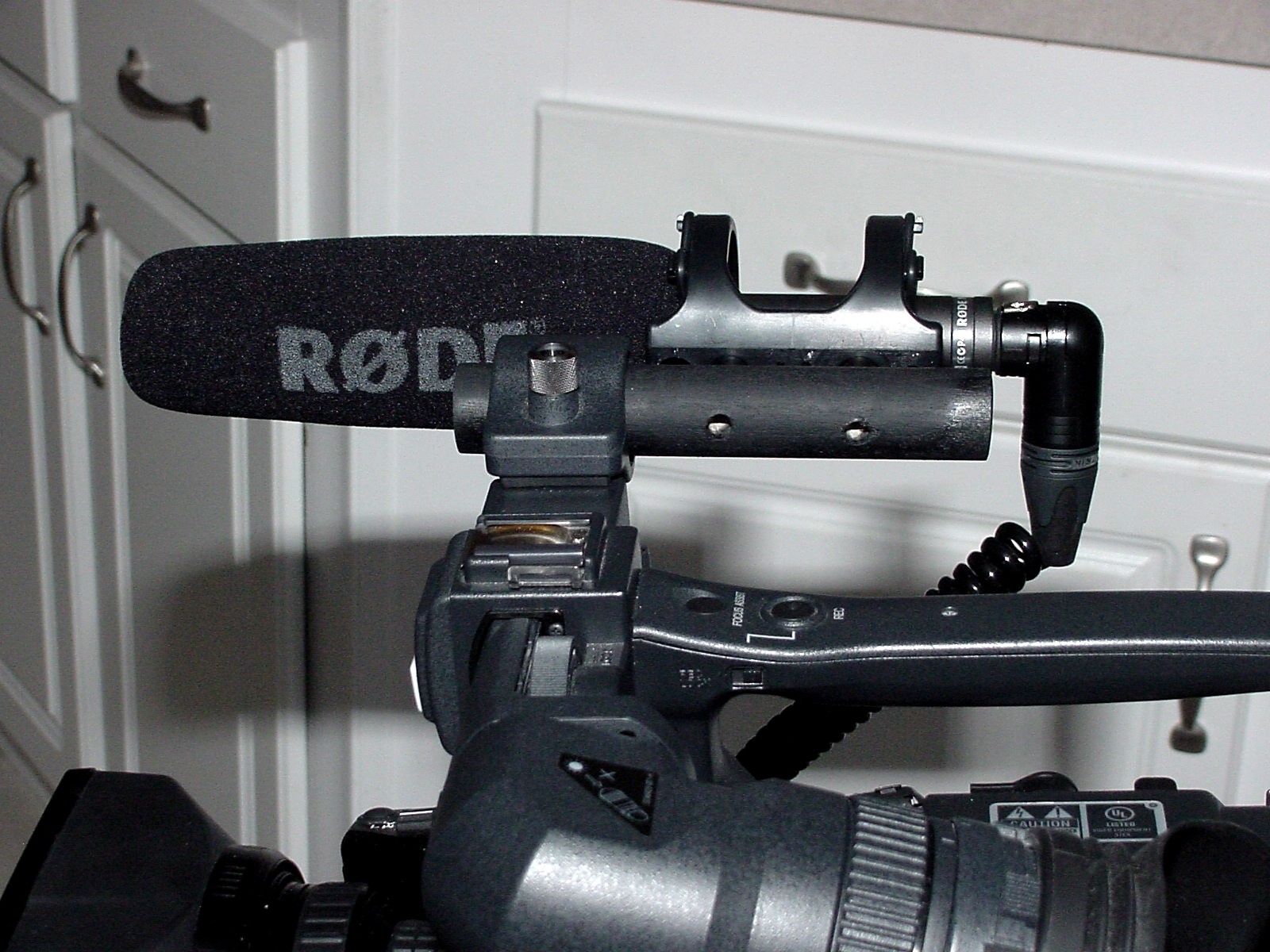

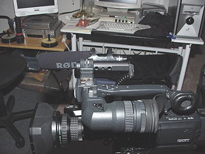

Old November 29th, 2007, 01:51 PM   #15
Posts: 291
Hello
iv'e change the cylindrical mount adapter on the SMD 5 suspension
its made of steel and very heavy and being that its 1.06 inchs in diameter
its was alot of strand on the mic holder/clamp
I went to home depot and got dowel 7/8 diameter same as my Rodes NTG-1
fits perfect in the mic holder line up the holes on the SMD5 suspension
mark em on the dowel and
drill the holes
I just uses the screws that came with the unit
i painted the dowel so it matches the rodes supension mic holder
what a difference , no more pressure on the jcv mic holder.
if i was just using tape no problem but with the Dr hd100
all kinds of noise
heres some pics
Joe
