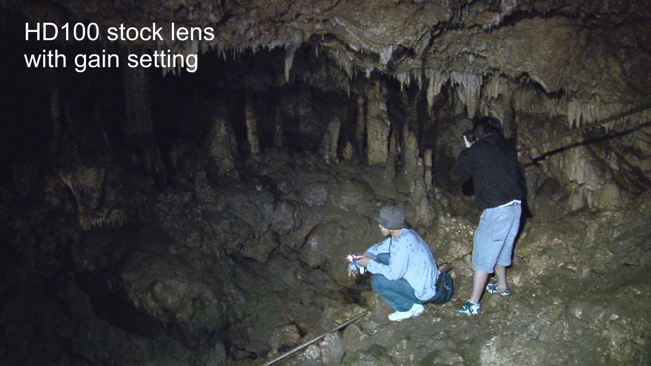

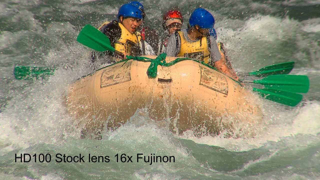

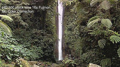

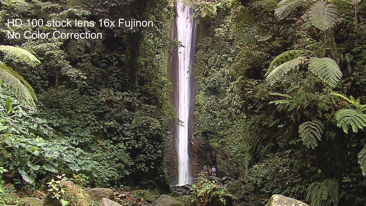

Heres some grabs you requested. The cave has gain setting, bit noisy but usable. The falls was in a dark ravine. Take note of my assistant standing on a rock at the bottom. Forget exact f stop but its wide open so note the top half of the waterfall is magenta, lower half is green. But still usable.
