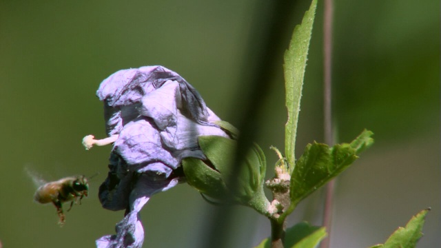

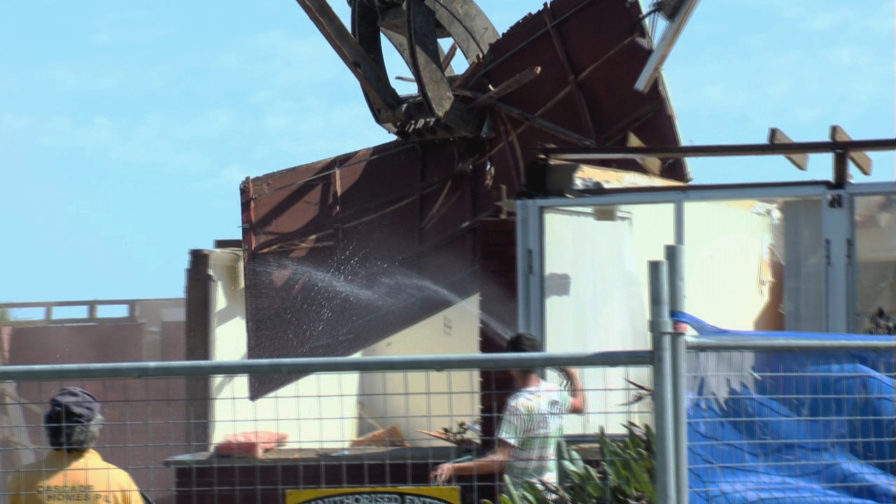

Here's a couple of stills from footage I shot this morning. (Granted both shots are a little overexposed.)
I love the bokeh from this lens but the CA is as bad as everyone has been saying it is, and also something I've not heard much about but seems quite evident is that blown highlights have a horrible purple fringe that I don't see in my Canon XH-A1.
Top marks to Paolo Ciccone for his TrueColor preset, it looks absolutely phenomenal!!
JT
