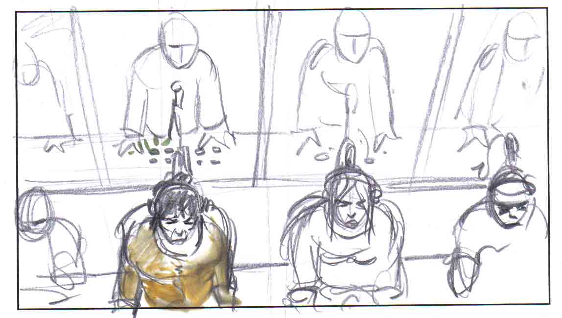

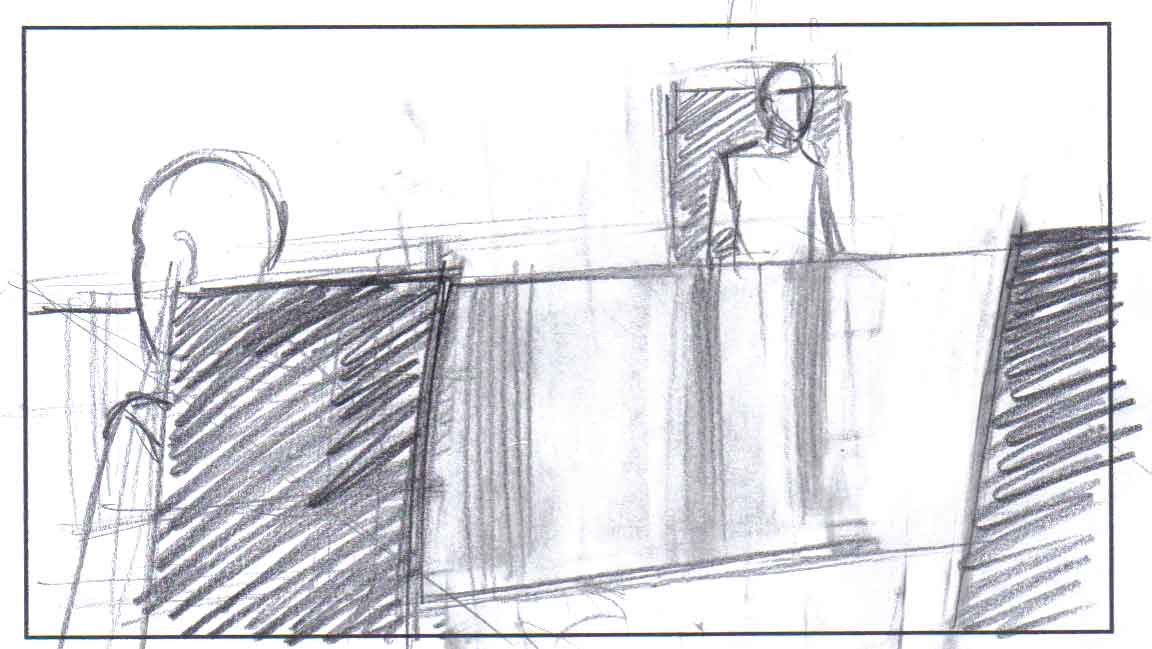

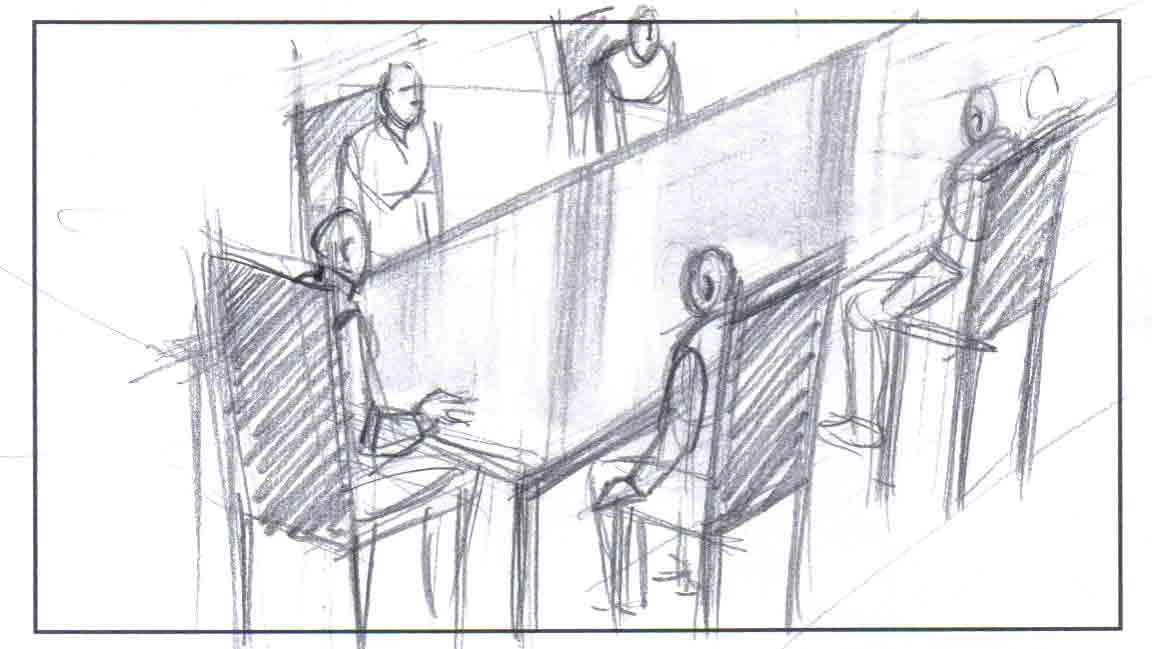

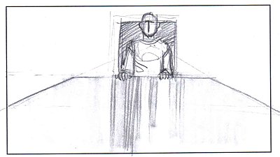

I'm shooting a short film in about 6 weeks' time in the Geneva area.
This is a project I'm shooting with freinds over a 4-day period, just for fun but totally professional cast, crew and equipment. No direct sound, ADR.
Using my Gy-HD251 with mini-35 400 and Zeiss HS lenses.
We'll record most scenes to the DR-HD100 in QT or m2t mode and camtape backup.
We have two greenkey scenes to be shot in a high-end studio near Geneva. (both take place in the building of some Global Population Formatting Bureau)
I figure it might make sense to shoot the greenkey scenes (ca. 5 min. in all) in 4:2:2 (10 bit ?) in order to facilitate the effects work to be done later on.
What's your opinion ? Anyone tried this out ? Using what hardware at the recording end ??
Thanks !
Attachments: STORYBOARD scenes 1 and 11
Short Film With Greenkey Scenes: 4:2:2-lo_scene_1_1.jpg   Short Film With Greenkey Scenes: 4:2:2-lo_scene_1_2.jpg
Short Film With Greenkey Scenes: 4:2:2-lo_scene_1_3.jpg   Short Film With Greenkey Scenes: 4:2:2-lo_scene_11_1.jpg
Claude Mangold is offline   Reply With Quote
