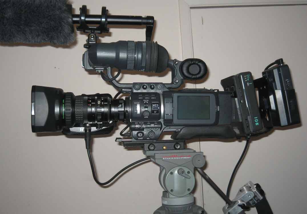

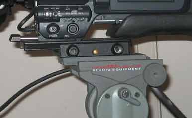

I balanced mine out with an extra manfroto tripod mount/plate that I had laying around on my shelf. It works fine.
I would prefer the tripod plate though since it probably locks in better and won't slide forward out and fall on the ground.... I bet there is a good way to secure the tail end of the camera to the plate to help cut down on the wiggeles while around 80mm.

Alex has the right idea, but it is still not completely balanced. From you pictures, you are putting the weight of this camera on this thin plate hanging well away from the center of the tripod, which could cause it to move quite a lot.
I have used cameras with tripod plates all my career, but never fully realized, I guess, what it was doing. When you shoulder mount the camera, you are balancing it in the middle, so that the weight of the lens and the weight of the AB battery are matched. Putting the camera on the front plate does not give it enough stability to balance this weight and it makes the weight uneven. When you use the plate, you are moving the weight from the uneven front plate to the middle. The shoulder pad of the camera, the actual balanced middle with a battery attached, is now directly above the head of the tripod, which is where there is the most stability.
Also when you shoulder it, you are giving it two points of stability: your shoulder and your hand on the lens. One does not do it for this camera because of the weight and the length, so the tripod plate adapter gives it that two point stability and spreads the weight out evenly.

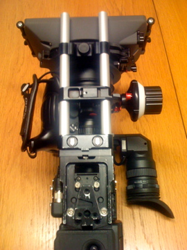

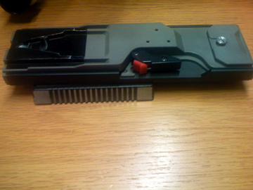

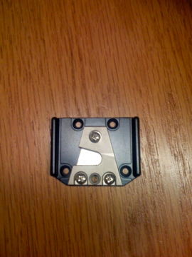

I have a Vocas rail support with integrated v-shoe (pix 0297) which screws on neatly in place of the standard jvc v-shoe which came with the camera (pix 0299). I just use an old sony U14 plate bolted on a heavy manfrotto tripod plate (pix 0300) which slides in the head until the correct balance is found (depends on what's on the cam: HD100, mini35, battery or no, etc.)
Vocas rail support is really useful and quick, so is Vocas mattebox. Vocas followfocus sucks.

From the Vocas user manual, I gather it's basplate 7a, item nr. 0350-0001. But before ordering, double-check with them. They respond quite quickly to emails.
I got this in an exchange from my vendor , Visuals in Geneva, after finding out that the baseplate "required" by vocas for this cam series (I believe it was model 7f) is totally useless: not stable, screws impossible to reach, no v-shoe etc.
When I look at it carefully, it appears that the two rear screwholes were not factory drilled. So this may have been specifically adapted for the GY -HD series by Visuals. I have detected no parts number on the plate itself.
The plate is super-useful because the mattebox, followfocus and rails can just be snapped on in one unit. When I use this camera myself, it's mostly for experimental films and location scouting, so I'm happy to have something that's ready quickly, even if the followfocus sucks a bit. But my DPs also like the mattbox with those integrated eyebrows, and it fits no prob on cine primes with the mini 35.
