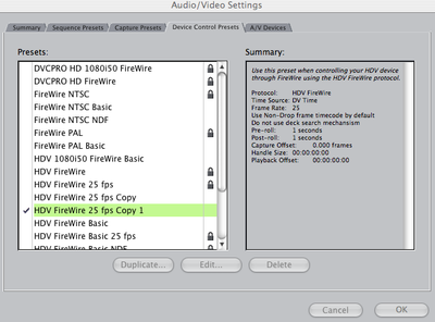

I'll test it with some old HDV 720p24 tapes next week. (I've got to re-capture about 30 tapes. So I hope I remember how to reduce the pre-roll to 1 second before then!)
If it's the same thing you're talking about David then it's under Audio/Video Settings as per the attached pic.
Bit odd that when I change my settings it, for some reason, creates a copy of the Set up (again see pic).
Unfortunately although I've had the latest firmware upgrade (and motherboard fix - although never found out what they actually did) I'm still getting broken clips and missing chunks of footage. I am however still running FCP5...I think if I can confirm FCP6 runs with 5:1 sound I might be persuaded to upgrade :)
Good news your set up is [FINALLY] working for you David.
Thanks, David. That really helped me.
I just set it to 1 second pre-roll and 1 second post-roll and recaptured an old HDV 720p24 tape. It was recorded with the TC GENE switch set to REGEN. There were 103 clips on that tape and it captured all in one go, splitting into separate clips for each take. The gaps were only about 2 seconds (2 1/4 seconds or so).
So it looks like you only lose one second at the beginning of each clip.
