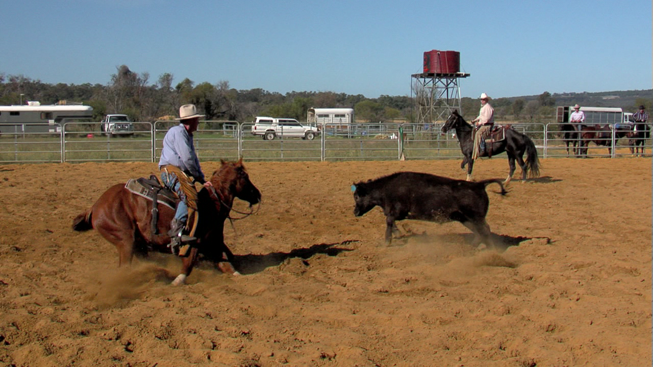

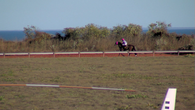

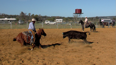

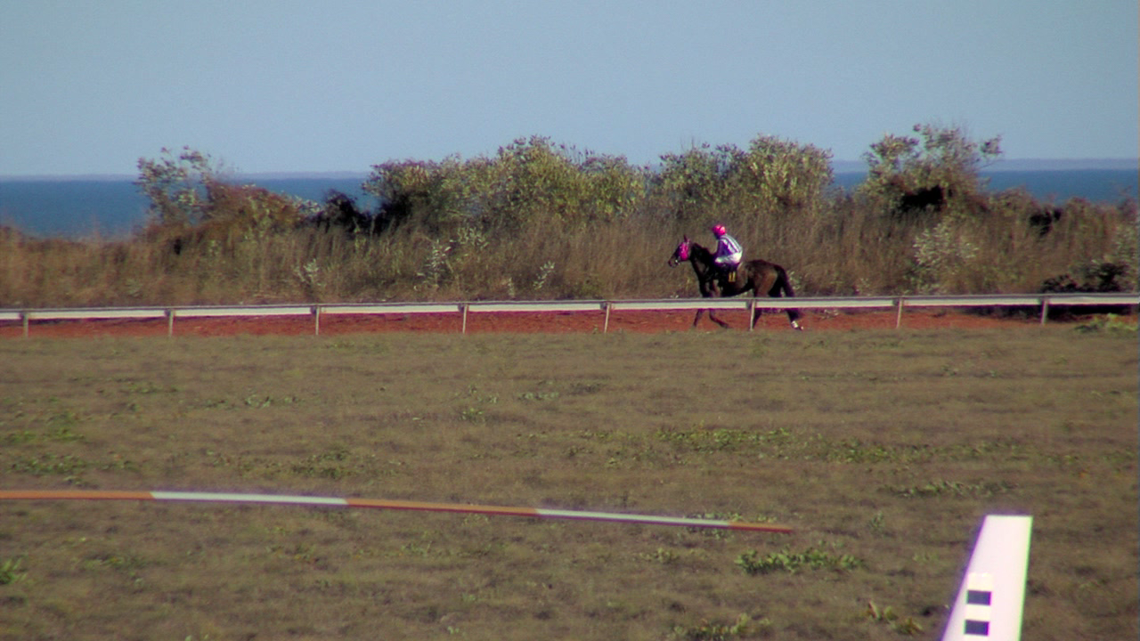

I think the user
of this lens will work basically within 20 metres (66ft) of his subject, beyond this you need to look at another lens. Softness and CA, which is typical of any lens at an extreme, but maybe lock into you mind what sort of range you think your work falls into. It's also true you reduce CA by stopping down, but often the case, especially only with a 1/3inch behind the lens, you need all the iris you can grab, and it's hard to then ward off those soft CA gremlins. A longer throw lens should help reduce this.
Also don't expect to shoot tight and get everything in, often I'm moving back to try and frame subjects completely. The 17x and 20x are only like 7%wider, but at least the 20x gives you an extra 12mm to play with at the long end.
If tight shooting is your thing, 13x hands down, if multifunctionality is necessary, as most of us fall under this, the 18x BERM is the beast, just has a beast of price.
My attached pics show what I mean, I'm shooting from on top of a clift over a dry river bed, so that's dictated how close the subject is, it's quite soft and heaps of CA. And again at a racecourse, same deal, but when shooting some cutting within the 20m, things are pretty sweet. (shot with the 16x of course)
(Edit: actually I just blew up the cutting pic, and that has a slight green CA on the back of the calf and the horse behind it. Oh well)

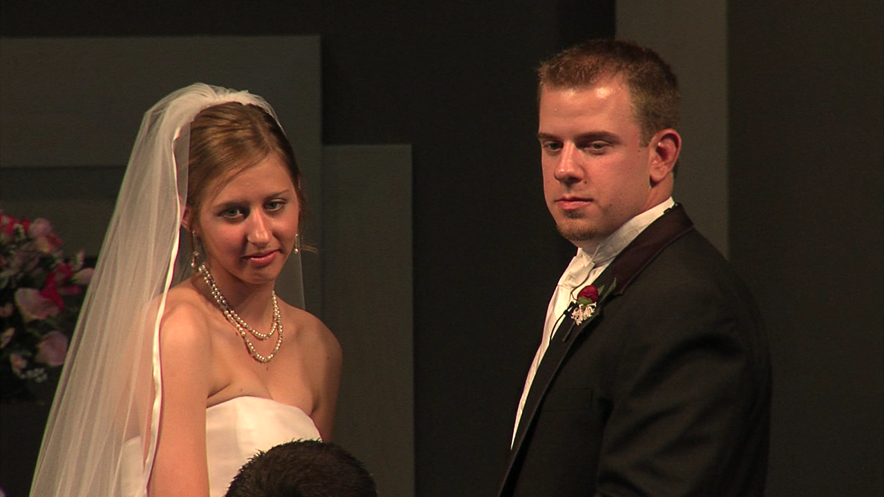

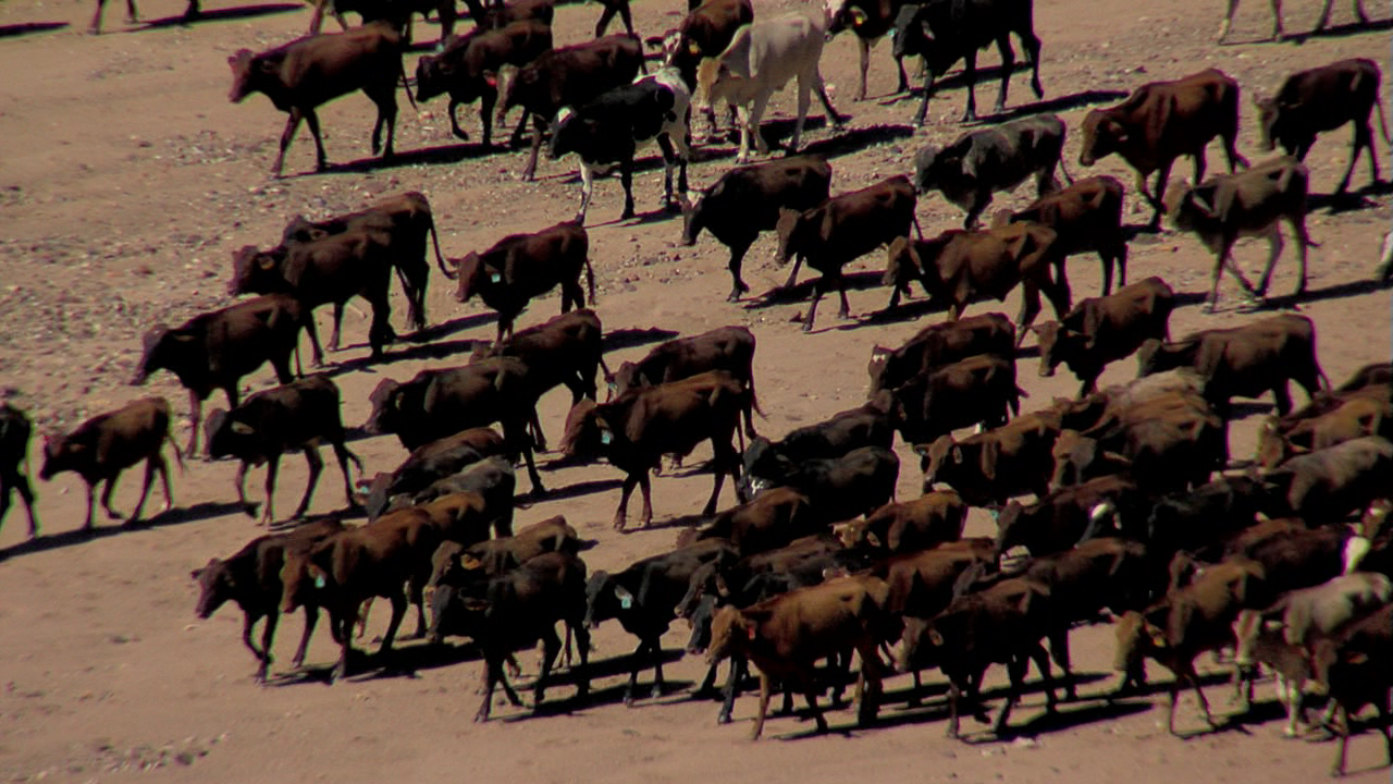

A couple of samples from a 200 with the 17x
Alex asked me to post a some images with the 17x. These are two where I was zoomed in pretty far. For my neice's wedding I was back about 125 ft. maybe a little more and I think I had about a 4 f/stop.
The lighthouse was a good 200 yds. distance and I had some zoom left to give. I 'm pretty sure the f/stop was around 11 with the ND2 filter.
My issue with the stock 16 may be the camera that the JVC replaced, a Sony DSR-300, had a nice 18x Canon lens that I was very familiar with and the look to expect. I do among other things quite a bit of 'live' video and I just couldn't get confortable with what I was shooting and even had a camera tech friend of mine check out the backfocus as detail just seemed to soften when zoomed back
How good/bad is the 16x5.5 lens really ??-vlcsnap-472381.png   How good/bad is the 16x5.5 lens really ??-vlcsnap-471045.png
