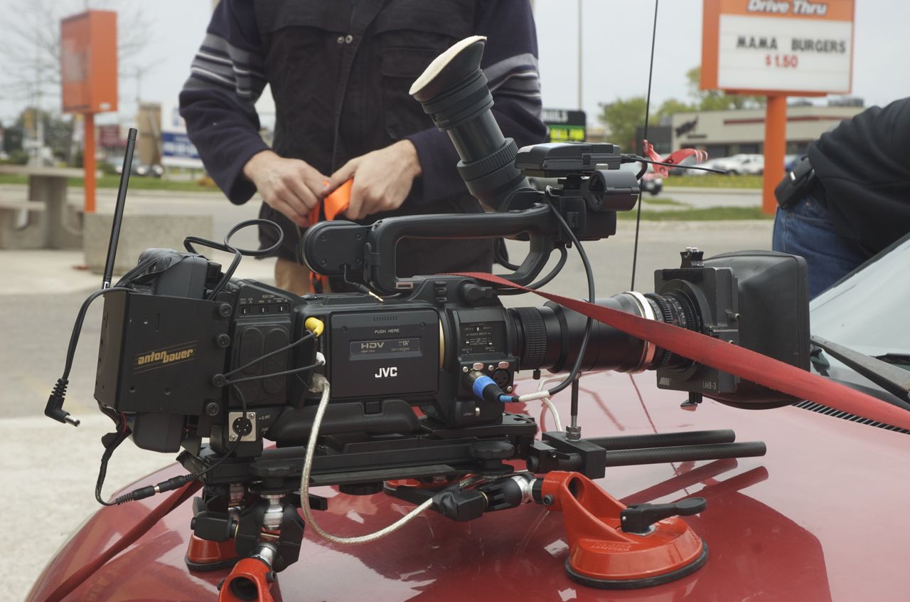

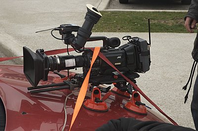

I'm now a convert to VFGadgets Pro-Gripper Quad.
I've had a full HD250 rig hood mounted with it (long legs are removable) even though that probably exceeds the maximum suggested weight of 14lbs.
Just make sure you strip the camera of everything unnecessary and ensure your grips use a couple ratchet straps and you'll be fine. I put the DR-HD100 DTE drive inside the car and used a really long firewire cable.

Thank you Paul but Tim's solution looks better for my needs.
Tim, the rig seams to be very versatile. Have you ever tried to use it with the long legs on the side of the car so the camera is 0,8-1 meter off the car. Would it be safe with the camera striped to minimum and the DR 100 inside the car as you suggested?
On the other hand is funny that the rig is USD 650 and the shipping is 850 .... .
Tim, thank you very much for your help,

2.8Ghz Video transmitter so the director could watch from the chase car and direct the actors with a walkie. It's a little haphazard because I bought the components and built it myself. It has a good range of about 100 feet.
