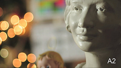

We used a very fast mid format 80mm f1.9 with a nikon adapter on the D90 and JVC with 35mm adapter.
A2 -D90 with mamiya at f1.9

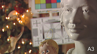

A3 -JVC with fujinon at f1.4 (this is not ideal, note the lateral CA)
While we know the stock fujinon is not at its best at wide, and while we know CA disappears at f2.8 we decided to push it to see if the stocklens+1/3chips can "theoretically" produce a pleasant shallow DOF by themselves versus an adapter or the D90.

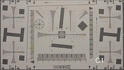

We had initial problems getting exposure on the D90 since we lit the charts with a flo softbox. The overhead flourescents that ran on ballasts seems to introduce lines at certain exposures. When we finally got a clear screen we locked exposure and took the shot.
C1- D90 50mmf1.4 @ f2.8
(notes: viewing the shot on a large CRT monitor it seems ok, but we noticed that the recorded image is significantly deteriorated when we played it back on the NLE.
Tell tale mosquito artifacts appear around the numbers on the chart.
The D90 seem to resolve around 460 to 500 on the horizontal lines. BUT the sensor seems to introduce a bluish/pinkish/yellowish mishmash on the moire areas especially on the thin black horizontal lines. This is the reason we pulled out the sony cam and included it in our test.)

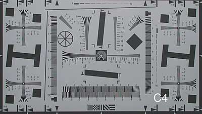

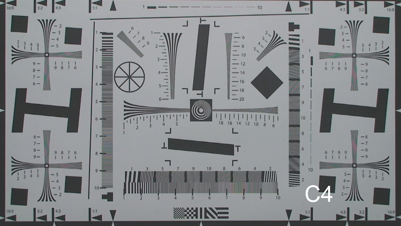

C4- Sony HD1000
(notes: we included this 1080i single CMOS cam to see if the mishmash of colors on the D90 chart is a product of the CMOS chip or the Codec.
Looking closely at the trumpets and the horizontal lines at the 700-900 range of the Sony chart we saw SIMILAR rainbowish colors patterns in areas that are supposedy thin black lines.
The D90 color "mishmash" on the thin moire prone areas of the chart are more pronounced which rules out the D90 cam if color accuracy is needed.
Is this CMOS issue or the MJPEG codec that aggravated it? I Don't know. I've used the MJPEG codec during my Matrox Digisuite editing days and didn't notice this.)

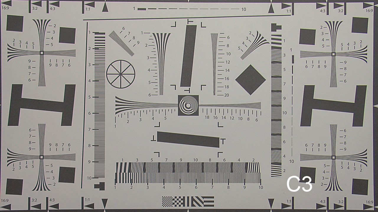

C3- JVC Fujinon 16x @f2.8
(notes: slight red/green fringe CA at the extreme sides, which is the nature of the 16x. Otherwise the Chart showed true circles and diagonal lines.)
