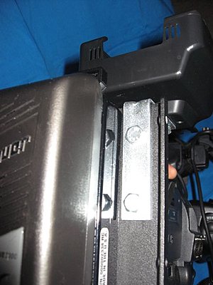

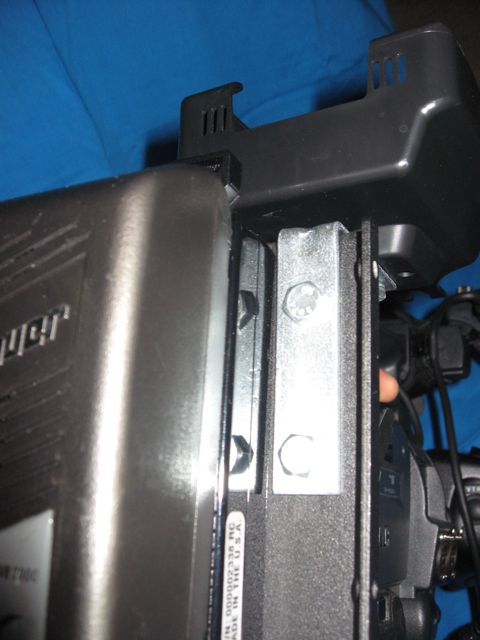

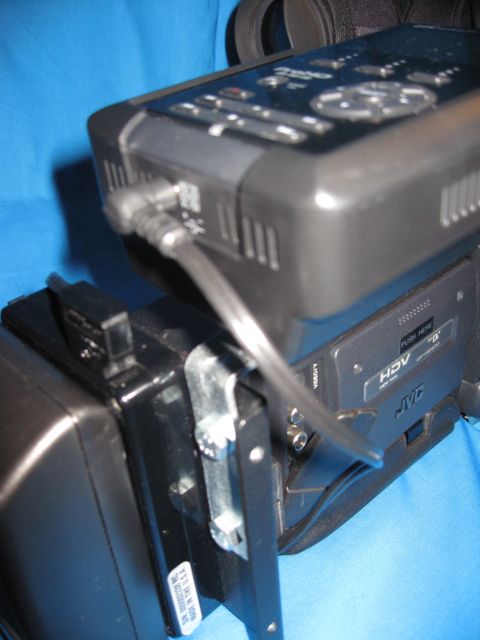

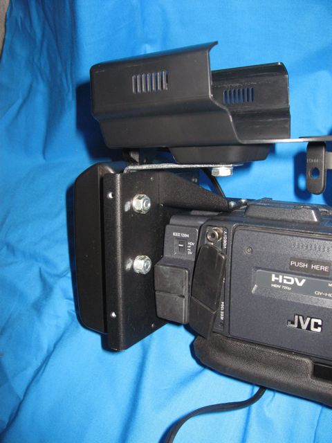

Simon, I have GY-HD100 and it also works with DR-HD100. So I would assume your GY110/111/200 will work just fine with Firestore. Not sure on MR100. When using DR-HD100 use m2t mode and re-wrap it to Quicktime to avoid audio buzz. Unfortunately FE never fixed this audio problem and made it for us a complete pain the ass.
I use AB battery and I drilled into the plate in the back, attached a right angle piece of metal and connected everything with the bolts. It works and was cheap, considering AB extra plates were about 75 bucks. I also run power tap cable from my AB to the firestore, as these batteries don't last worth a crap.

This is the set-up. Unfortunately I bought the cable, but you can rig one up for much less.
