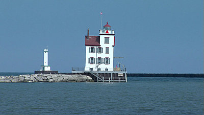

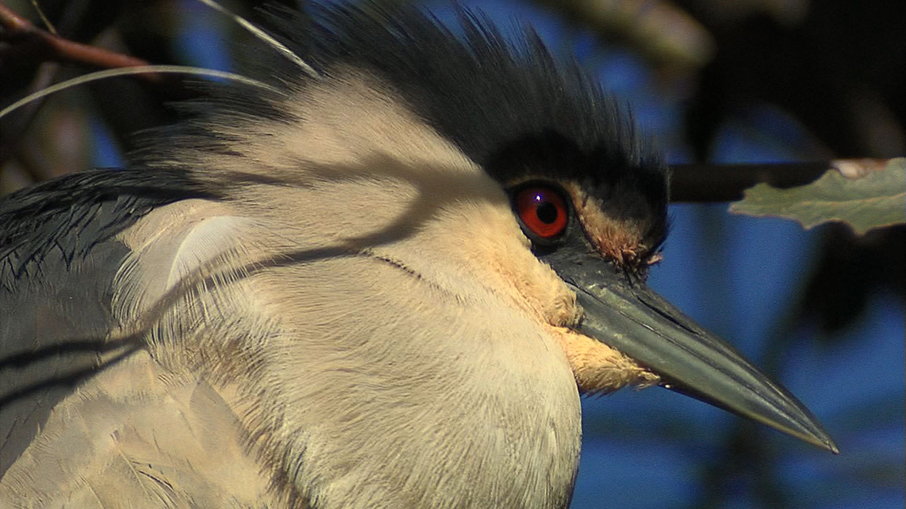

Here are a couple pics from another user (Mike? Steve? Paul? South Bay area (Nor-Cal) who was selling his MTF last I spoke to him a year ago...)
The Heron is with a MTF & Nikkor 80-200 and it looks about 200mm. The second pic is from a Fujinon 17x. No idea of focal length or aperture, but looks like it's near it's max and I could only guess on the aperture... probably near f11 I'm guessing.... oh and obviously click on the image to see the full size. Saved as jpg at 60% so the original footage looks slightly better.. not enough to worry about though.
MTF 1/3" Nikon "G" Adapter-mtfnikkor80-200.jpg   MTF 1/3" Nikon "G" Adapter-fujinon17x.jpg

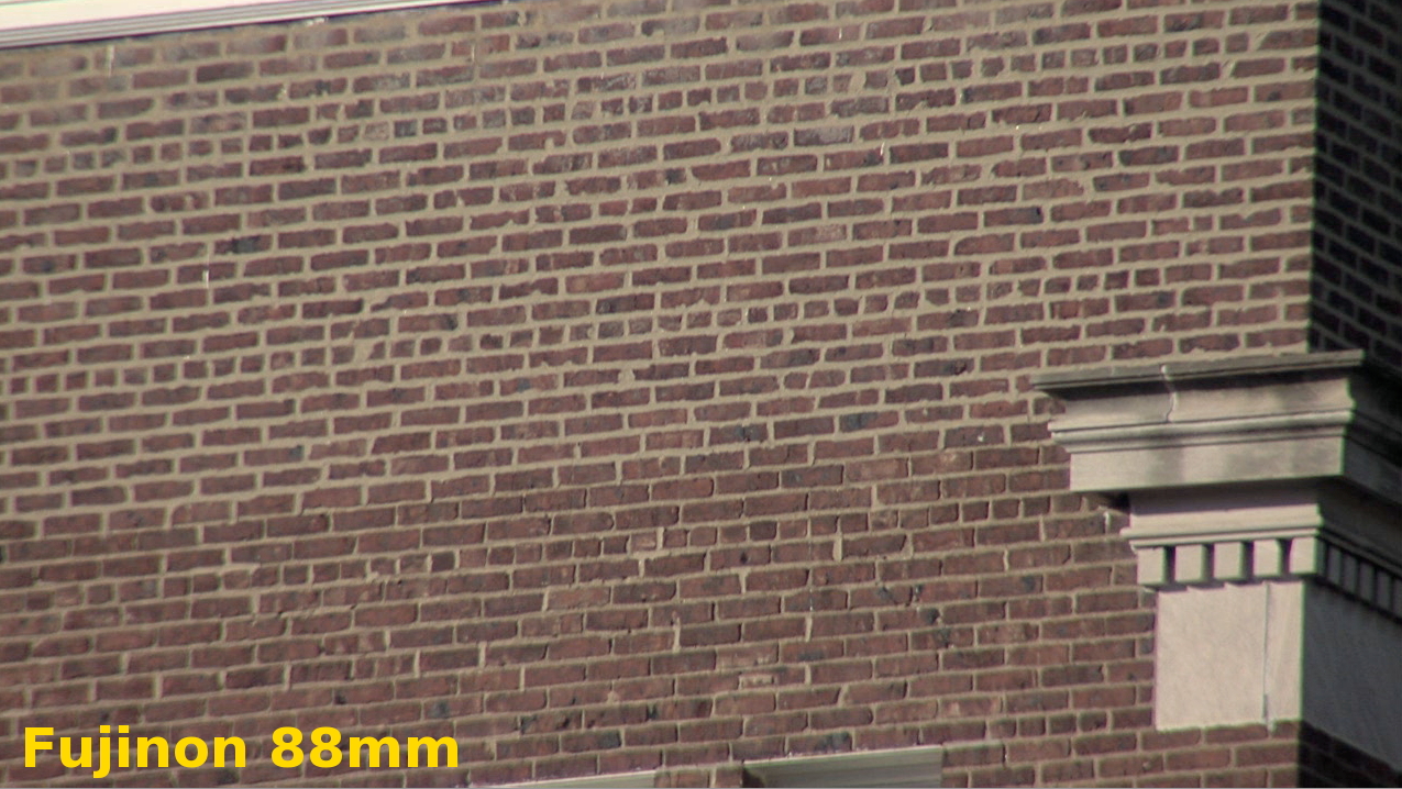

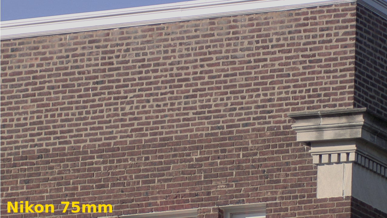

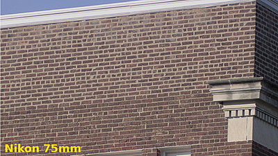

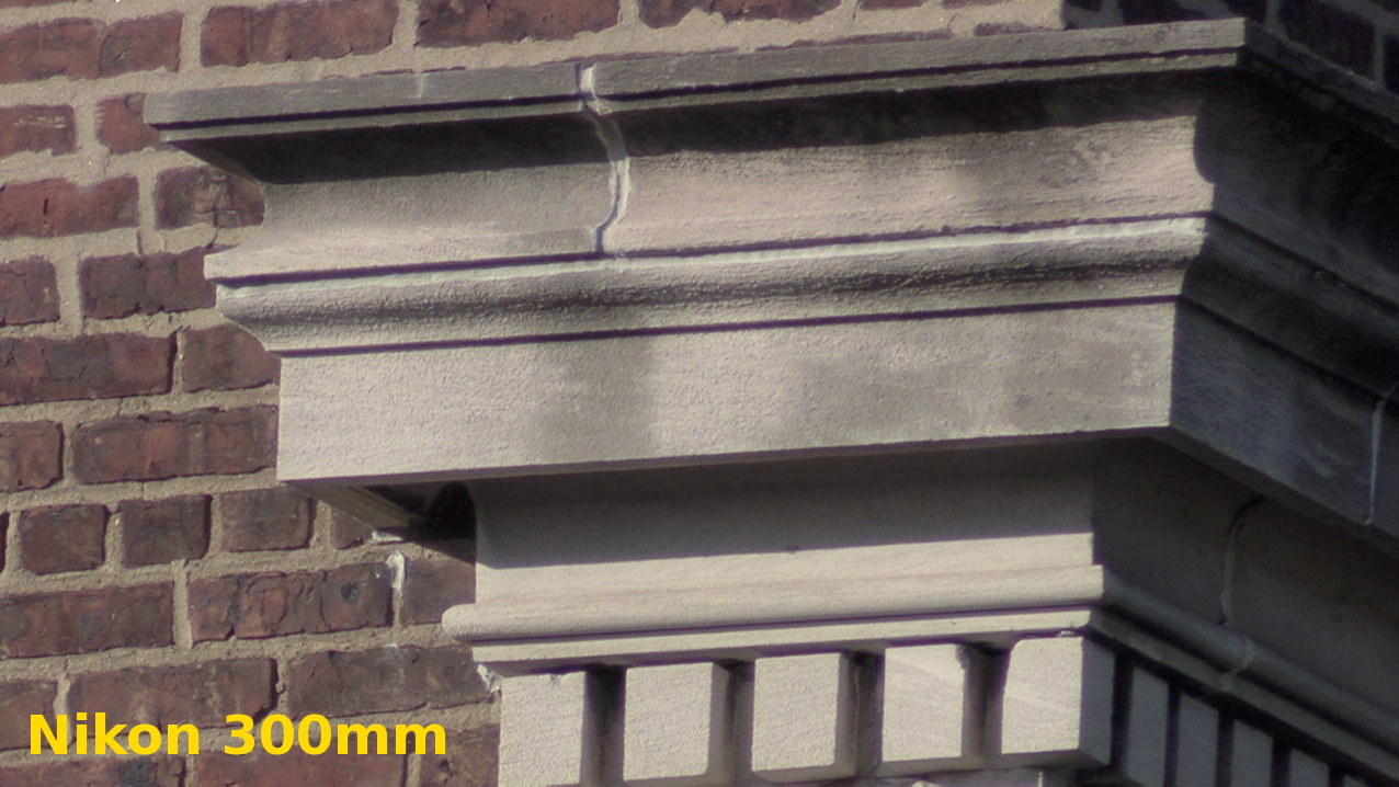

Posts: 162
Images!

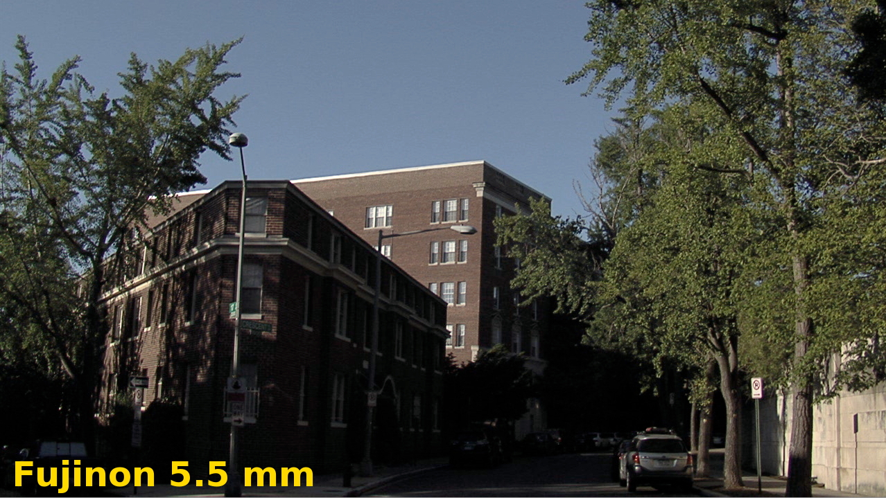

I received the Nikon --> 1/3" JVC bayonet adapter today and tested it. Overall, the craftsmanship is top notch. Backfocus is perfect, and the lens sits tight inside the adapter which fits perfectly into the bayonet of the JVC. No wiggling, not too tight, just perfect.
Then I put a Nikon 75-300mm 4.5-5.6 lens on it. I couldn't believe how perfect the lens works. Look for yourself and inspect the screen shots below.
The 1st image is the Fujinon stock lens at 5.5mm (wide), f/5.6
The 2nd image is the Fujinon stock lens at 88mm (tele), f/5.6
The 3rd image is the Nikon at 75mm, f/5.6
The 4th image is the Nikon at 300mm, f/5.6
Overall, the Nikon gives perfectly sharp images over the entire field, well suited for HD. Even at 300mm, there is little chromatic aberration.
The Fujinon at tele (88mm) and the Nikon at 75mm have almost the exact same field of view. The Nikon is perfectly sharper across the entire field and lacks CA completely. In contrast, the Fujinon is not sharp across the entire field and has a lot of CA, making this lens useless at that range.
In short: The Nikon lens easily outperforms the Fujinon lens. Keep in mind that the Nikon costs only $150.- and it's not even a Nikon ED glass!
Also, look at the gigantic zoom range that I have now (images 1 through 4)!

MTF 1/3" Nikon "G" Adapter-fujinon_5.5mm.jpg   MTF 1/3" Nikon "G" Adapter-fujinon_88mm.jpg
MTF 1/3" Nikon "G" Adapter-nikon_75mm.jpg   MTF 1/3" Nikon "G" Adapter-nikon_300mm.jpg
