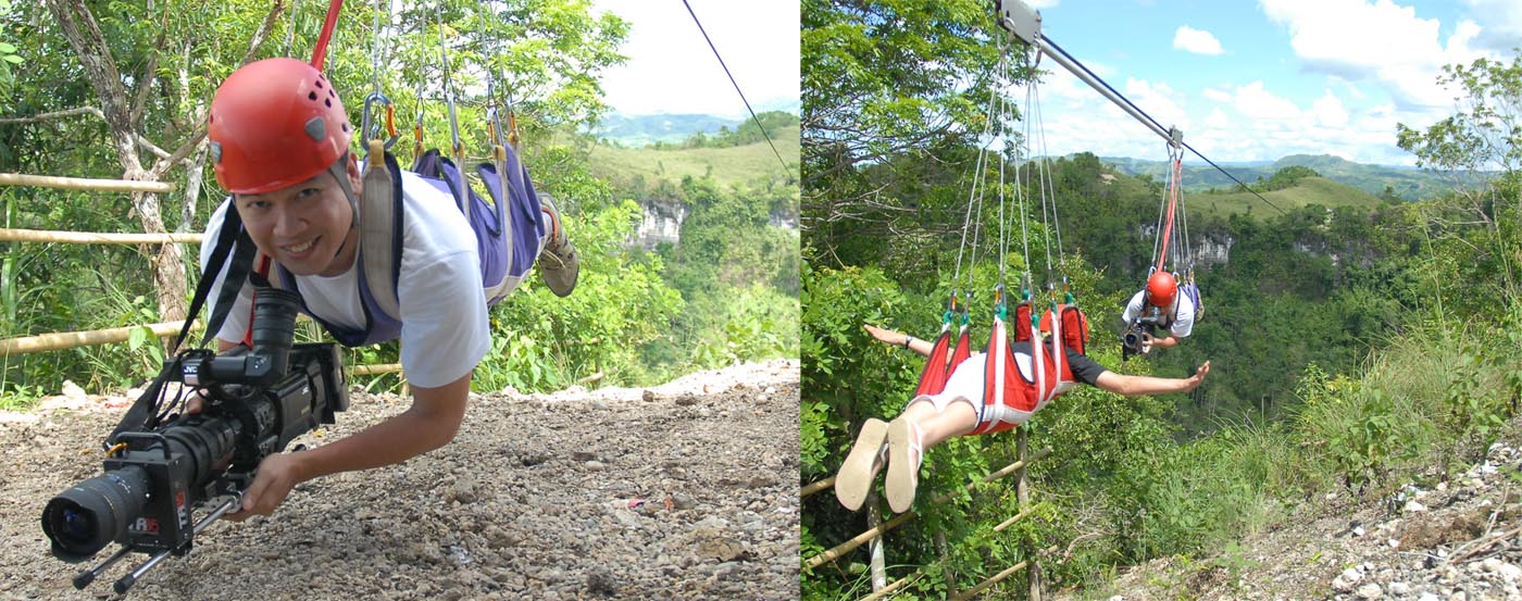

I just finished a shoot this morning while strapped on a cable zip line 122 METERS over a river gorge shooting a talent zipping on a cable line behind me.
It was a hand held shot with the 200 attached with my DIY adapter screwed on the 82mm filter thread via 72 to 82 step down ring.
A rail mount is essential. If you go redrock then you can also get their rail mount. As for me, I made my own rail mount.

Tom,
In my experience with using adapters and with the JVC in particular, you can get optimum e2e quality if you can get the achromat closer to front lens element on the stock 16x.
most brand adapterswill provide a 82 to 72 step down ring to fit the fujinon filter thread then place the 72mm achromat onto this ring.
I have tested the cinevate achromat, 1st versions, which is similar to the redrocks. Im talking about the achromats before they designed new ones for the ex cameras.
They didnt match with the jvc's well. The one that made a good match was the achromat from the sgpro.
Also, upon the suggestion of Bob Hart (a regular dvinfo poster in these threads) who helped me with my tests, I moved the achromat deeper into the front focus barrel of the fujinon. Note that the front glass element is recessed deep inside the barrel.
I did this by removing the anti flare ring in the front of the lens. But if this is hard to remove try to retro fit an 82mm uv filter for this purpose.
Considering the length of this weapon, it is best to have a rail mount to support the adapter and 35mm lens.
I'm attaching a pic of my shoot this morning to show you how utterly mad i became to get the shot hand held.
Ted

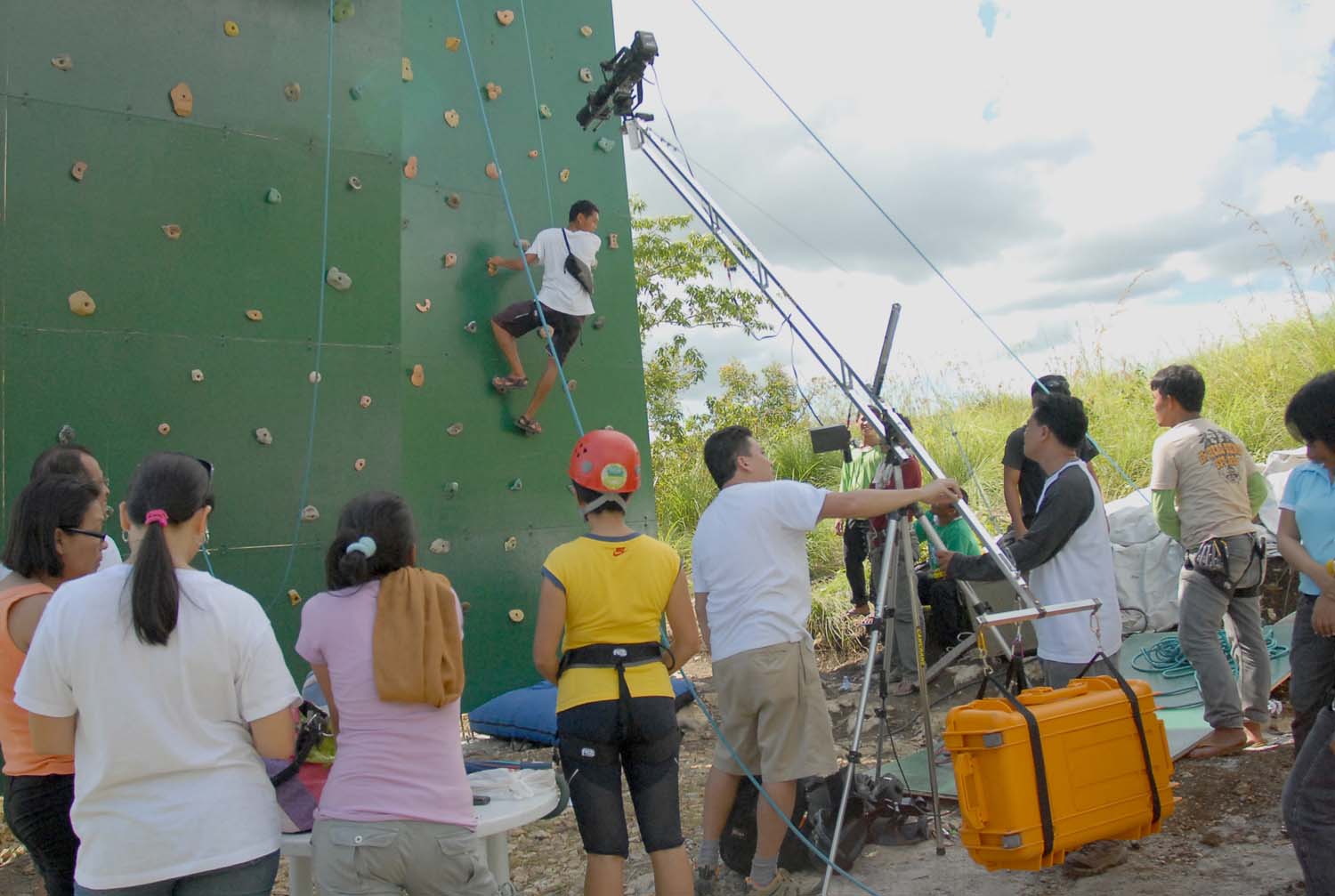

When using a jib, the shift from hd100 to hd200 added SIGNIFICANT counterweight requirements. this is due to the heavy ab battery in addition to lens adapter + lens + firestore. AND because of this I also had to replace the jib head to a heavier manfrotto head.
Tom,
by showing you the rigors this rigs can go through you'll see how important a reliable rail or mount system is to hold this rather long rig together.

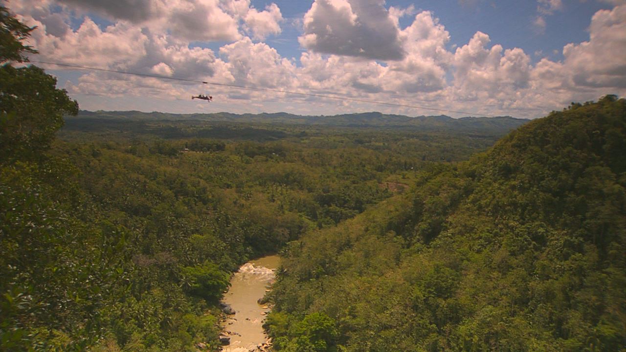

I'm attaching another pic of the JVC with lens adapter, a 15-30 wide zoom on a jib that I made.
Also it might interest you, since your planning on getting a redrock, that i recently replaced the GG of my diy adapter with a redrock gg so im also attaching a wide shot frame grab of the gorge taken with the 15-30 sigma at f8 so you'll see the quality of their original GG. Note that the new m2e gg is said to be better in low light.
I still keep my DIY gg which performs much better in lowlight, provided i keep my lenses wide open, in case i need low light performance. The redrock gg's loses more light BUT give flexibility of allowing you to close down even up to f16 on certain lenses.
