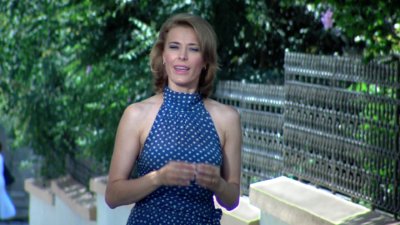

Recent one
HM 700, 3,5X13,F2
The elbow.
A plugin to solve this issue will be very welcome.
Good luck
Eugen
Please upload frame grabs of Chromatic Aberration-ca.tif

Eugen,doesn't this look more like fringing ? you've got a shady underside of elbow against a very bright (maybe even in parts blown) surface on the wall. and on the dark blue edge of dress next.
I'm not really sure any digital cam could handle such enormous contrast without any side effects.
For me, I'd be worried about the green rim on the wall top, and aren't there just hints of real CA in the out-of-focus metal fence?
