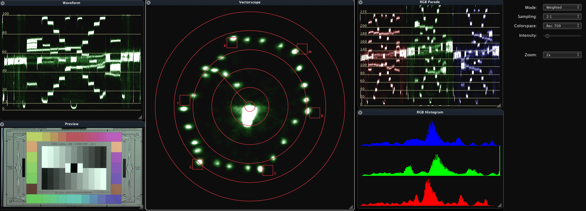

The HD100 series camera always had a magenta bias out-of-the-box. It is fairly easy to adjust with a combination of the matrix controls and the white paint controls.
I'm sorry I don't have the SG Blade or your particular Nikon lens, which would be required for me to create a calibrated setting for you.
However, this is a setting I have for the old stock Fujinon lens 16x5.5 that should work well for skin tone at the expense of slightly greenish yellows. (JVC added an extra adjustment to control yellow/green in the HM700 - I wish the HD-series had it!)
Do an AWB white balance first (you can't tweak white paint with WB presets.)
COLOR MATRIX and GAMMA STANDARD
R GAIN 1
R ROT 3
G GAIN 2
G ROT -1
B GAIN 2
B ROT -1
WHITE PAINT R -15
WHITE PAINT B -5
I know it looks crazy on paper but it actually subdues the luminance of the red channel while maintaining proper tonal qualities. Please try it out and let me know if it improves your particular setup.
