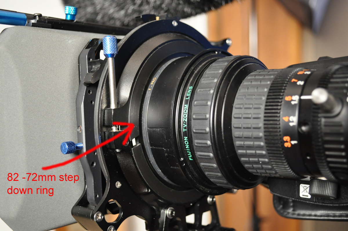

Correct, I am using the 72mm adapter because I originally purchased the Genus matte box & rails for my Sony FX1. I then purchased a HD200, loved it more and thought I would try fitting the mattebox to the JVC. Everything works great! The newer rail systems by Genus are highly adaptable and rock solid, the matte box will not budge. I purchased the genus step down ring so I could fit the mattebox donut to the 82mm thread onto the HD200 lense.

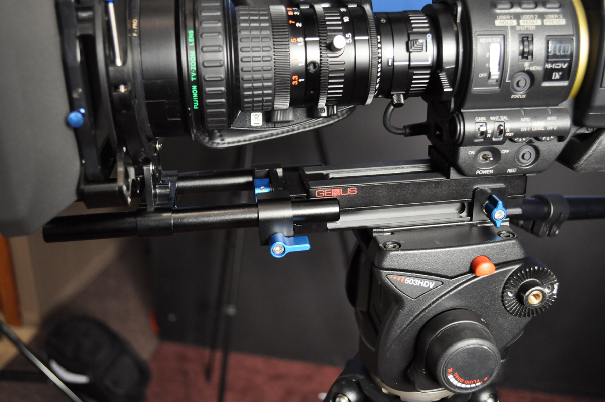

I will try and post some photos tommorow of the kit, the only problem like I was is the weight distribution of the camera while on a tripod. These rails do not jive with a tripod plate and as such a standard plate is quite far forward (on bottom of the rails) and the center of gravity is way off. I am trying to design a work around or perhaps my own plate. I use the camera on shoulder 90% of time, so perhaps I can live with it.

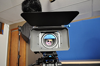

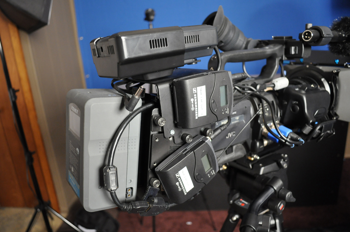

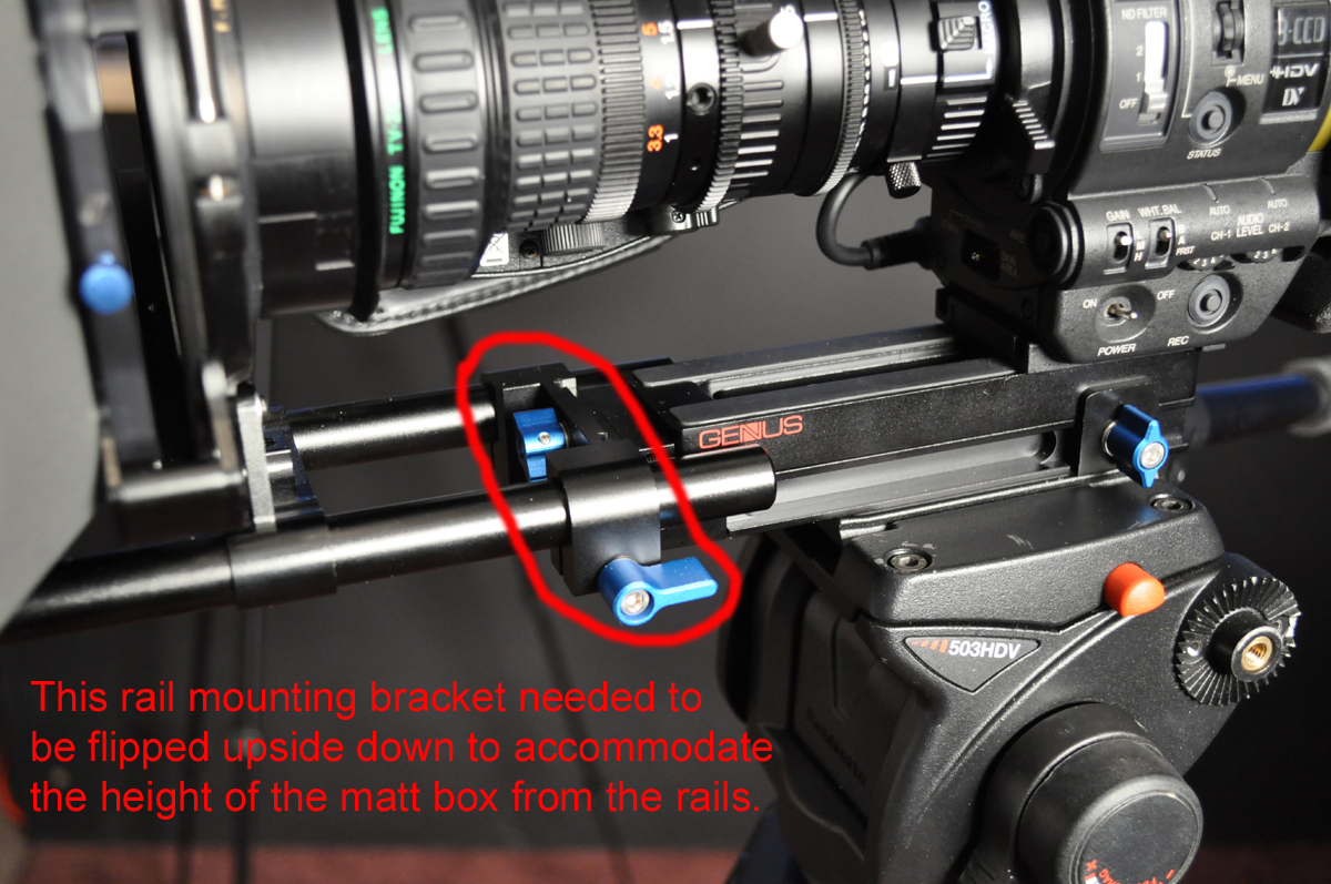

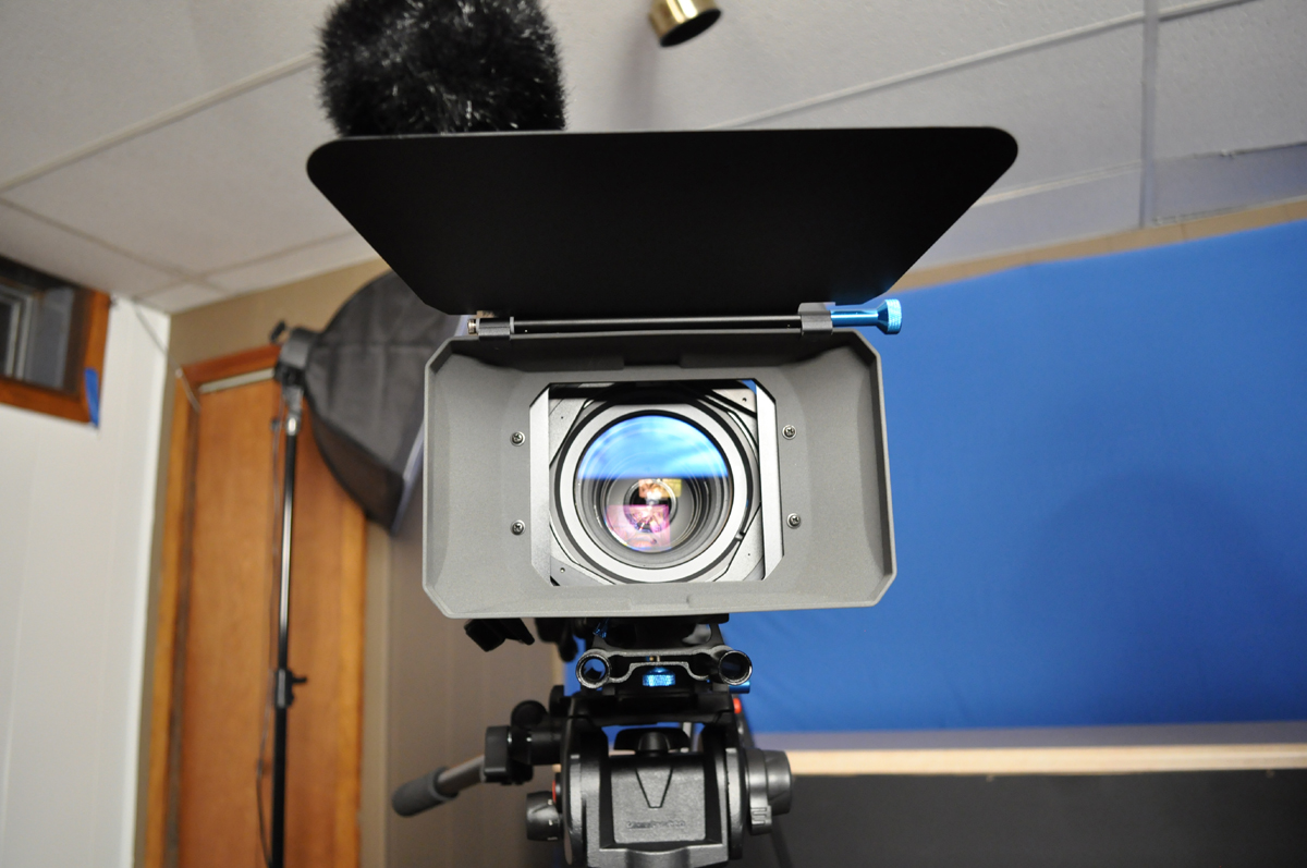

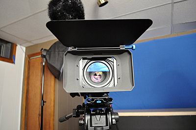

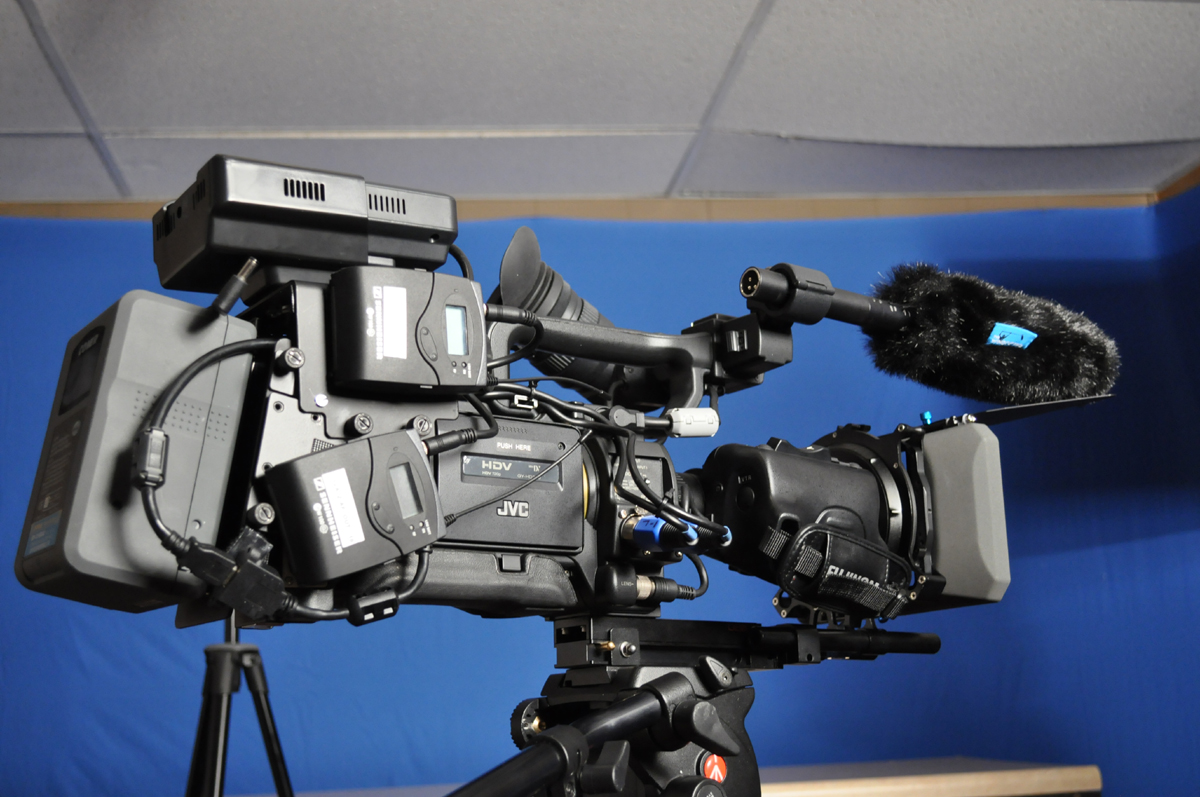

Genus Matte Box & JVC HD200 (Photos)
Jay,
I finally got around to posting some pics of my HD200 and the Genus Matte Box. I didn't realize how dusty the camera was until these were taken!
Anyway, as you can see, the rails and Matte Box I had for my FX1 fit fine, although a few tweaks were needed including the 82-72 mm step down ring and also the front rail mounting bracket needed to be flipped upside down. However there is a lot of weight at the back of the camera with the batteries, radios and hard drive attached. The center of gravity is where the shoulder pad is, not where the small tripod plate currently is located. I am worried it may snap off, although I have 1/4 bolts holding the plate to the Genus, but the rails only have 1 bolt holding to the camera. It's seems rock solid, but this is not the ideal setup for a tripod. A v-mount standard JVC plate will not work with these rails. Like I say, I am using the camera on the shoulder 90% of the time, but I am looking into a better tripod plate solution.

Rich,
Thanks for posting these pics. I see what you mean about the plate and weight distribution etc.

No probs Jay, Like I say the Genus rails and plate I am using was designed for the FX1. I am chatting to Genus now about a plate that will work with the HD200 and allow the tripod plate to be positioned correctly, I will let you know what I find.

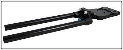

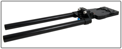

Just a quick update on this thread. The solution to the tripod balance issue previously mentioned is to use the Genus Adaptor Bars System (GMB/P) which works with the JVC or Sony VCT-U14 plate. The chaps at Genus sent me one to test and it fits perfectly on the HD200 and with the tripod plate. The GMB/P bars work with Genus matte boxes.
Genus Professional Adaptor Bars System - Genus
