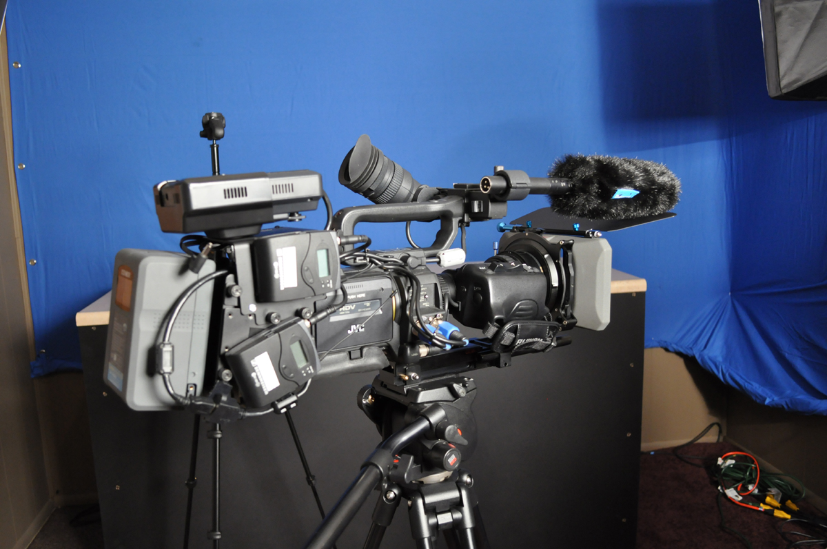

I have my hard drive mounted up on top and 2 wireless receivers with Velcro and clips mounted on the battery side plate, it's very solid.
http://www.dvinfo.net/forum/attachme...matte_box4.jpg
Also a must have is the firewire insulator - this is the one I am using permanently on the camera.
FireWire Port Isolator - 6pin - 6 inch
Rich Perry is offline   Reply With Quote
