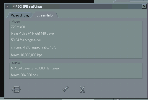

Here is the Datastream info.
It's the same as 720pXX
This makes the bits per pixel even more hardy because the chance of being bit starved is pretty small. 480p60 scales up well but the 576p50 is even better. Remember 60% slow mo for 50fps and 50% for 60fps.
good luck...
