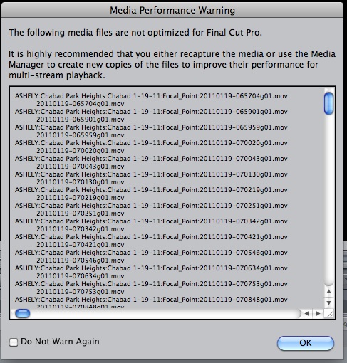

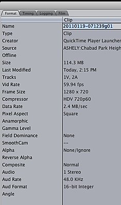

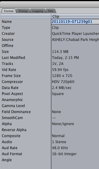

My camera is the JVC HD 200 and I'm shooting 720p60 to both tape (as a back up) and the Firestore MR-HD100 (primary). The footage is being saved as Quicktime files. I'm editing on a 2010 Mac Pro with FCP 7.0.3
When I try to import everything directly into FCP, I get a warning that says "The following media files are not optimized for FCP. It is highly recommended that you either recapture the media or use media manager to create new copies of the files to improve their performance for multi-stream playback". Then it lists all the file names.
The item properties for everything shows that the clips are 1280x720 at 59.94fps and that the compressor is HDV 720p60. Why am I getting this message? Isn't HDV good enough?

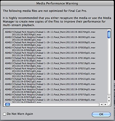

Here are some freeze frames if that helps.

Ignore the warning.
Open a test sequence with one of these 'warning clips' and export it with best settings (Suggest a TIFF Sequence uncompressed export as an image sequence of 10-20 frames). Then export a 'control clip' (the same clip imported individually). Compare both with your eyes.
If you don't trust your eyes, and if you have a compositing app or photoshop, import two matching frames from both clips. Then apply the difference blend and see if the image is pure black. If it is, you're okay. There is no better test.
I think you should be fine. If you do hear from tech, please let me know.

I just tried the import again. If I only import 1 - 5 files I get no warning message. If I go a few above that, it only lists the last few files as being bad. If I then try another import that starts at those bad files, it will import them ok and make the new last few files bad. Without being too scientific, if I do a large import it shows about 30% of the files being bad. But if I start the import with those bad files it shows them as being ok.
