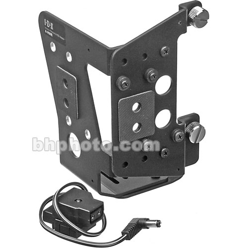

Does anyone know if the A-HWR mounting bracket (fancy name by IDX: "Wireless receiver and HDD adapter") mounted on the A-E2HD100 IDX V-mount power adapter... does it leave enough space for TWO IDX E-7 (stackable) batteries?
Here is a picture of the A-HWR bracket. Do the screws on the right side serve the purpose of adapting the bracket's opening in order to accomodate the extra battery?

I have this bracket as we use it to mount our DR-HD100 harddrive and radio mic(s). But we use the standard IDX 7 batteries, not the stackable type, and so have never altered it and use it as seen in the picture....
But if there is anything you need help with -measurements etc let me know..

Dan, what I wanted to know if it is extendable so two of those batteries would fit in. If you use an E-7S battery, the opening you need is just under 35mm. I need about 75-80mm in order to mount two E-7 batteries.
Would you please check if the bracke is extendable to accomodate 80mm?

Tonight I took a look at the bracket and found that it has 3 different lengths it can be set at. I put it on the third/furthest setting and it gave a distance of 98mm from the back of the camera -which is more than enough space to put two of our 7s batteries if we needed or could do so! So I am sure it would be ample for what you require.
I have taken a couple of photographs of my mobile phone if you needed a visual reference. But essentially on the image you attached above, you can see two sets of three horizonal screw holes which allow for it to be set at three different distances. You have to do it on the side of the bracket and separately on the base of it as well. The larger screws with spacers actually seem to be completely redundant and I have no idea what their purpose is.
Hope that helps!

That means I can fit in at the minimum two E-7 batteries and possibly even a wireless mike receiver. The FS-H200 can then go on the back of the bracket.
If you have the time, please upload those pictures, or if it's easier, shoot them to me via email, efarkas at gmail dot com.
