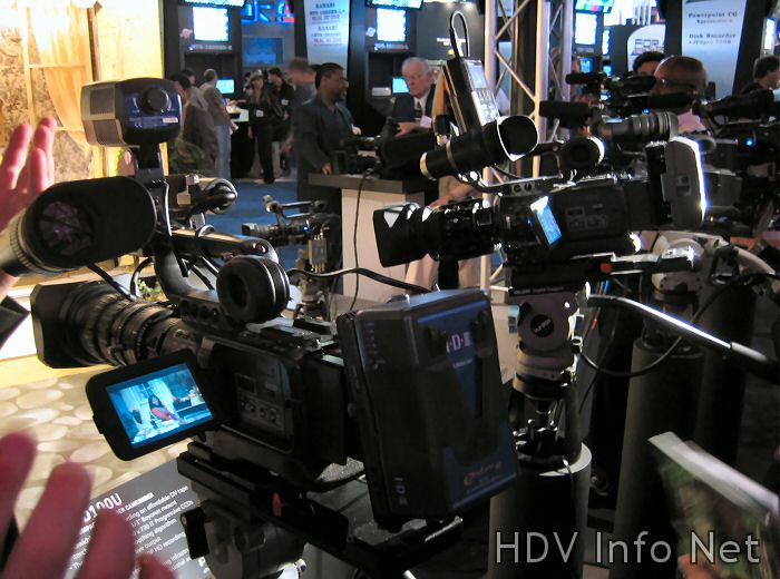

Does anyone know what parts are needed to effect the V mount battery use? Here at http://www.dvinfo.net/gallery/files/3/hd100all.jpg there is a photo of the HD100 with an IDX battery on it but I have never seen a specific part that has the IDX battery mount.
So what do you buy?

I have my new camera and have made my own adapter plate which was quite simple.
I bought 2 x IDX batteries and charger and also a small v-lock plate which had a 4 pin xlr output and had 2 output voltages from the 4 pins, 14.4v and 7.2v
Next i cut a small piece of aluminium about 60 mm wide and 150 mm long, 3mm thick and bent it to the correct angle to follow the profile of the rear of the camera. There are 2 screws on the top of the camera which i took out and mounted the aluminium plate there, using the existing screws.
The adapter IDX v-lock thingy was attached to the aluminium bracket , then rewired to give me 7.2v into the camera and now has a 4 pin xlr housing attached to the aluminium bracket giving me 14.4v for my top light when i need it.
This may be a slighly bulkier option than having the yet to be released "IDX approved" one but it cost me next to nothing and works fine. (The only other option when i bought the camera was to buy 6 normal batteries. No thanks)
