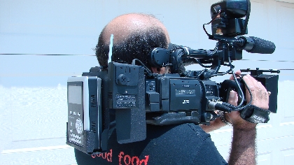

Battery Recommendation For GY-HD100U
You mentioned that there are several recommendations outside the usual A-B and IDX route but I've failed to find anything outside those AND the weak little BN-V438 etc.
I'm scrambling to pull a rabbit outta my hat right now because I just got a JVC HD110U with the Varizoom dual mount and I've been working all week to cobble something together with very dismal results. If there is ONE design flaw in this camera, and believe you me I tried to find more, it is the lack of a simple XLR-4 power connector.
JVC designed the camera with the "handycam" battery in mind and when A-B and IDX stepped in with their solutions JVC was apparently happy to leave sleeping dogs alone.
To further add insult the blasted 438's are way overpriced for such a small unit and hard to find.
Please share with us those "other recommendations".
I'll shell out what I have to in order to get them.
Anyone who can come up with a reliable system could make some serious coin.
Here is my 110U with a homebuilt bracket to accomodate the Firestore.
(I'm waiting to receive my HD100/60 so the FS-4 is there as a "dummy")
Jeffery Haas is offline   Reply With Quote
