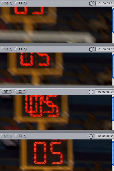

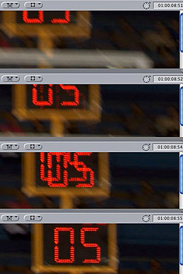

I know this conversation is veering away from the original question of slo-mo samples, but I find it interesting.
Barry, that was a great clip, and very telling of how Panasonic is handling the pixel shift.
It is interesting to watch the clock during the clip. Assuming the clock cycles at 60Hz, it gives us an indication of how fast the pixel shifting samples each pass. Since this was a 24P clip, it looks like the HVX200 is sampling at either 48Hz (2-passes per frame) or 96Hz (4-passes per frame) and then using some smart algorithm to predict motion blur. The only problem here was that it couldn't figure out the clock because it flickered at 60Hz, and we ended up getting double images on some frames.
This reminds me of the effect of a butterfly shutter (aka bowtie shutter) on a CP16.
http://homepage.mac.com/timdashwood/...200-motion.jpg
Now back to the slo-mo question: I'm curious to see a 720P60 captured clip from the HVX200. I would guess it would have to sample at 120Hz in order to interpolate the full 720 lines. I'm curious how accurate that info would be.
I really should spend more time in the HVX forum! I could see the HVX200 making an ideal crash-cam for overcranking on stunts, pyro. etc.
Does Anyone Have Any HD100 Slo-Mo Footage That Can Be Posted?-hvx200-motion.jpg
