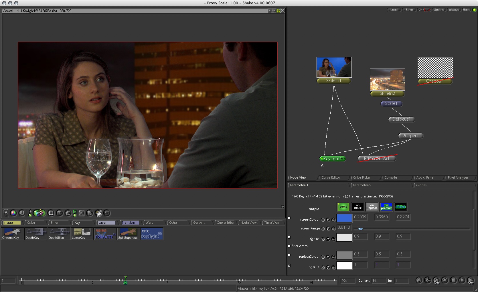

How good is the blue screen image? Paolo and others have reported issues with chromakeying--mentioning stair stepping etc.
What kind of results did you get?

I haven't had a chance to tweak yet but here's a prelim test grab.
