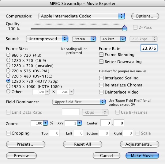

Your problem before was that you used "24" for a frame rate instead of "23.976" Please look at the attached jpeg to see what your settings should look like for good results.

How accurate is MPEG Streamclip conversion with JVC 720p24?-screengrab-19.jpg

Thanks Tim. (Yet again.) I was definitely missing something! I just tried it on that same test clip with 23.976 and it worked like a charm.
One of the things I do like about HDVxDV is that it gives you an exact 24 frames. (I'm in a PAL area and only ever have to convert to 25 frames/sec and don't usually have to worry about 29.97 compatibility.) As my edited sequence already is 65 minutes long (without the new footage) and all in an exact 24 frames, I'll adopt the workflow of conversion in MPEG Streamclip at 23.976, then pull the clips into Cinema Tools and conform them to an exact 24 frames, then import into FCP.
