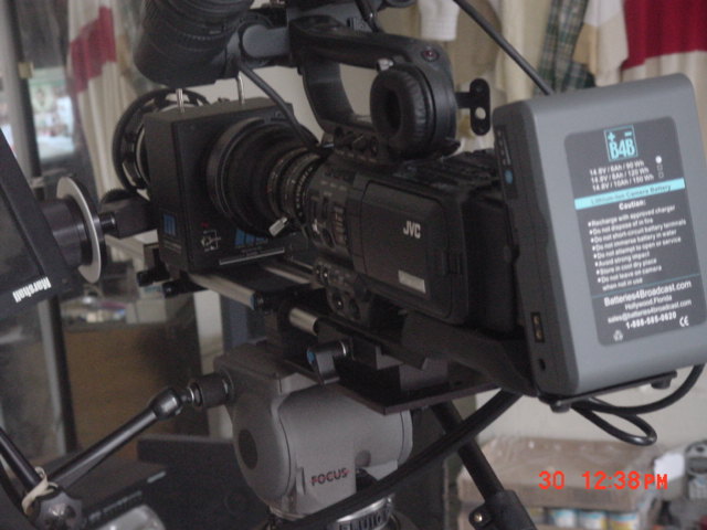

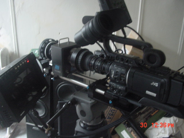

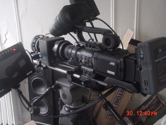

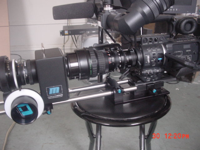

here's a setup with the monitor .
Connecting Marshall monitor to camera-jvc-hd100-redrock-7.jpg   Connecting Marshall monitor to camera-jvc-hd100-redrock-5.jpg
Connecting Marshall monitor to camera-dsc01023.jpg   Connecting Marshall monitor to camera-jvc-hd100-redrock-2.jpg

Suddenly it all makes a whole lot of sense.
Thanks for those pictures. How are you powering the monitor?
Chris

everything (hd100+hdd+monitor) from the single battery (Model Number SM-4060) from http://www.batteries4broadcast.com/battery2_sm_pop.htm and i get little over 3 hours running time .thanks

I would agree that mounting the heavier marshall on the handle part of camera puts undue stress on the camera and it is possible to crack the handle as I have done it. While the option pictured above is nice for studio, it doesn't work handheld. I have a different solution; bogen manfrotto sells an adapter plate that is basically a quick release with a balance plate attached. This balance plate has 3/8" and 1/4" threaded holes built right into the side of it. You can thread in an articulated arm straight in and then if you want to go handheld or run and gun, just leave the whole thing on and detach below the balance plate. Here is a link and picture from a site that sells the plate I speak of: http://www.evsonline.com/merchant2/m...egory_Code=4B2
