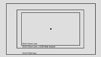

What is the approximate "wideness" of the 13x3.5 lens as compared to the 16x5.5 lens.
If I were to put an adapter on the stock 16x5.5 lens, what would I need to get the same "wideness" as the 13x3.5 lens? Would it be .8? .7? .65? or what?
Old July 6th, 2006, 03:19 PM   #17
Location: Toronto, ON, Canada
Posts: 3,637

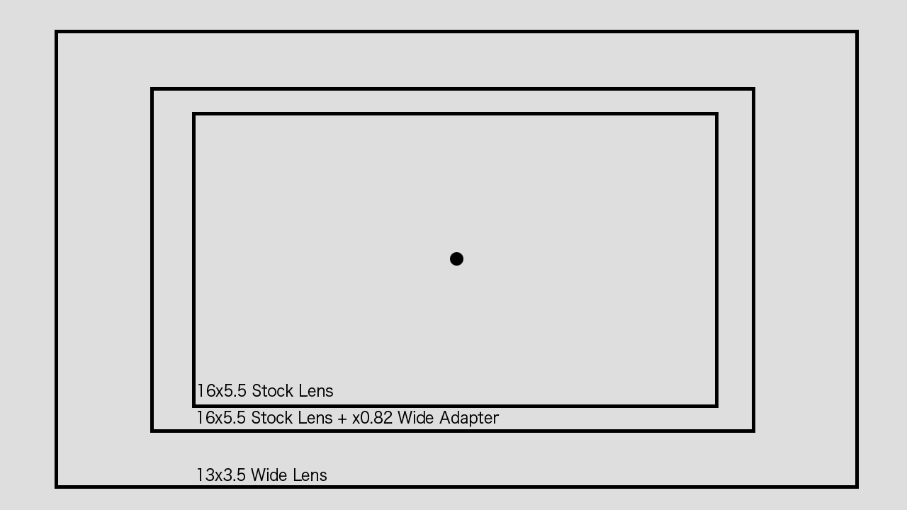

3.5/5.5 = .63
Attached is a measured comparison of Field of View.
Tim Dashwood
16x = 48 degrees
16x & WAA = 58 degrees
13x = 70 degrees
The 13x is definately the eng style lens to have. The question came up about adding the WAA to the 13x lens. What would happen? 80 degrees?

Originally Posted by Stephen L. Noe
16x = 48 degrees
13x = 70 degrees
The WAA for the 16x5.5 won't fit on the 13x3.5 lens.
However, there are two wide adapters from Fuji designed for it.
The WCV-85C will give you 0.8X for effective 2.8mm.
The WAT-85C will give you 0.7X for effective 2.45mm.
All the accessories are on page 16 of the lens manual.
Tim Dashwood
