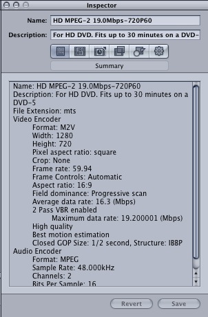

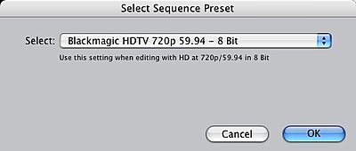

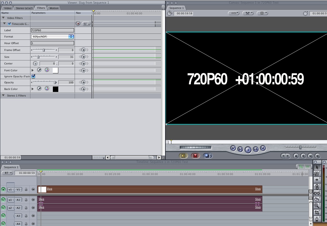

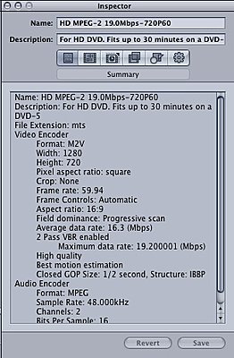

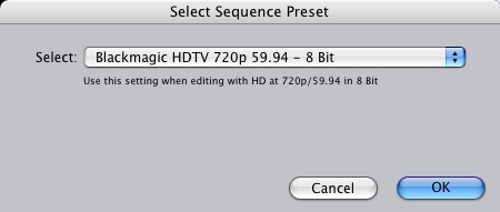

So I completed my 720P60 test and the deck seems to support the format.
I created a 720P60 file with black slug and applied the TC generator effect set for 60P TC.
I then exported as a quicktime and created a 720P60 mpeg2 setting in compressor 2. I couldn't manually set the closed GOP frame value, and it seems to be set to 1/2 second (30 frames) by default. However, I don't think the decompressor cares what the GOP is.
I then used DVHSCap to output the stream via firewire. The deck then went into "HDV-HD60P" mode, the "60" LED on the front of the deck lit up and the stream started playing out to the deck. I hit record and managed to record a bit of the stream to tape.
When I played back the clip from tape it didn't switch over to HD60P mode quick enough for me to watch the short (10 second) clip I had encoded. I should have exported more of it, and I probably shouldn't have recorded onto a test tape with 720P24 on either side.
So...

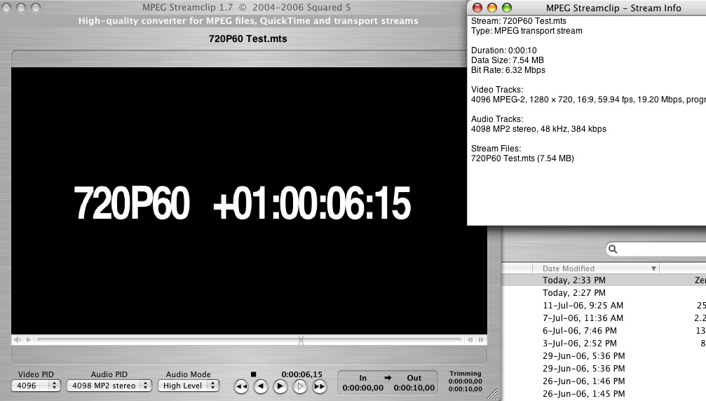

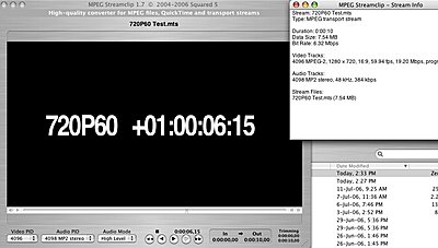

I had a second go at it with some JVC 1080P footage that comes with the SRDVD100 player. (The same demo material they used at NAB on all of the monitors and projectors) I used Mpegstreamclip to downconvert the 1080P to 720P60 and created a 720P60 ts stream again.
This time it worked perfectly and the footage looked great. HDV-HD60 mode, recorded and played back.
So, it seems the BR-HD50 deck is already 720P60 capable, and my firmware is only version 1.02
