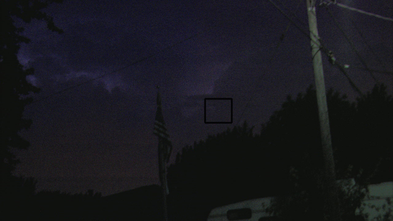

On another note, my HD100U-A just started showing 2 hot pixels when
the gain is turned on. A few weeks ago this was not the case.

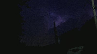

I just shot lightning and noticed split screen at 9db and 18db....after a day getting it back refirmware-ated :). Not like i actually care for gain, nor ever care to use it, but i was wondering if I'm still supposed to get split screen while it already being calibrated?
Another note is that I noticed a white pixel on 18 gain
Here is what both looked like....
BTW my intentions were not to look for this, I noticed it when I got back.

In your split screen jpeg, the SSE is obvious, however, in your hot pixel jpeg, the SSE is almost undetectable, but it's the same shot.
My question is, did the SSE only last a couple of frames? If so, that is normal. The DSP need more time to calibrate in low lighting conditions. Had the SSE stayed that way the entire time, then you would have an issue.

I was shooting the other night in practically no light and finaly managed to make the split screen appear after so many months of trying. It only stayed for about 5 minutes until my unit warmed up then it went away. I also had the gain set to 18db. What is surprising to me is Dashwoods "low-light" scene file if actually more affective then 18db gain. What I was doing half the time( just as a test. none of this footage is being used for anything other then my home tests) was using the "low-light" scene file and the cranking the gain up to 18db and getting an image that could easily be blown out. And it was nearly pitch black out. Just thought I'd share that even though the last half is kind of irrelevant.

Well it doesn't bother me, only the fact that last week I shot some night footage, but it involved a little bit more lighting, although i only used 12db at max. Below I have SSE from before it was services at 12db, then another SSE at 18db. So seems like i'm getting more than just a couple frames. I noticed though that it'll only happen in certain lighting situations.
The bad part about this is just noticing it. Personally if I'm shooting something, I prefer not to use gain at all, but when the time comes and I'm shooting a low light event, there will be no way in viewing this problem unless viewing it on a different monitor. So if I bought this A version and redid the firmware, what's the point in getting it serviced again if this problem will continue in unpredictable situations. I'm sort of dissapointed because at first it didn't bother me as I heard it mostly occurs at 18, but seeing how 12db is mostly suitable in really extensive low light conditions and still getting it, just saddens me, especially since it happened after being reupgraded.
