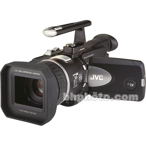

Jvc Gr-hd1
Thanks George,
I wonder if this camera would shoot compatible 720p video alongside the JVC-HD100...
I'm a little confused, but I think it shoots 720p at 30p fps, which would be fine I think?
Also the price of this camera is great for me if it works.
It would also be a great "cheaper" deck for that camera as well I think?
I have listed a quote from jvc on the key features of the camera.
JVC GR-HD1
Key Features
The Digital Hi-Def camcorder records in both NTSC and U.S. ATSC HDTV standard video on a standard Mini DV cassette. Recording can be done in 4:3 480i (DV compression) as well as 16:9 480/60p and 16:9 720/30p (MPEG-2 compression). In analog component it plays back in 480i (NTSC) and 480/60p, 720/60p, 1080i (ATSC), making it compatible with virtually all display devices. Its digital i.LINK outputs IEEE 1394-compliant 480i (NTSC) and 480/60p, 720/30p (ATSC) to D-VHS or computers via the FireWire connection.
To maximize its application potential in the field, and assure seamless transfer to a variety of post-production environments, the camcorder is equipped with three ATSC compatible shooting modes:
HD Mode that records 720/30p digital high-definition images,
SD Mode for 525p progressive wide images, and
DV Mode which records at conventional NTSC 480i DV standard.
High efficiency 6 frame group of pictures (GOP) Hi-Def MPEG compression allows the same recording time for HD on Mini DV cassettes as for standard SD DV compression.
