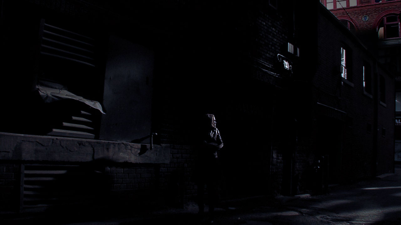

You can see in the attached image that a little post work will be required for the reflections in the windows and the other building in the upper right corner. This was shot at around 10AM in October.
Scene File Request: Day for Night-day-night.jpg

did you use a certain scene file for that night shot?
Nima Taheri is offline   Reply With Quote

Spectacular. Thanks, Tim.
