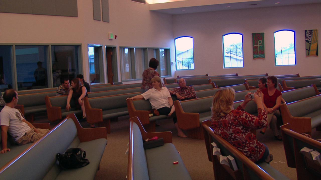

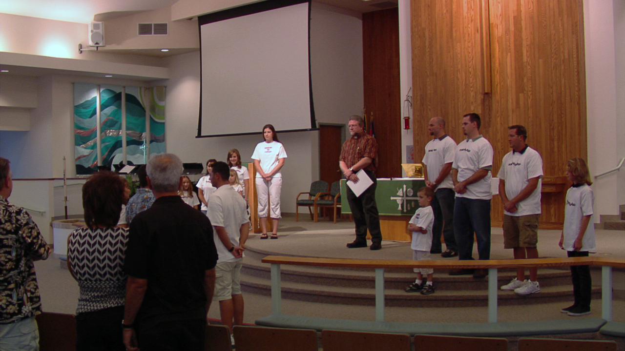

Hi there,
I just shot some footage at a wedding rehearsal and I was wondering if the footage looked bland to any of you guys. I want the picture to be kind of warm but I am really bad and inexperienced when it comes to white balance. I used the 3200k preset and I have been thinking about maybe raising it to make the picture warmer but obviously I don't want to be too warm.
Any tips would be great. I am also using Paulo Ciccone's tc v.3.
Also, is it wise to overexpose a little with the hd100?
hd100 white balance advice needed-hd100frame.jpg   hd100 white balance advice needed-hd100wedding.jpg

You are in a mixed colour temperature situation. If you choose 3200K, then the skin tones will look normal, but the windows and anyone lit by them will look blue (especially on a cloudy day.) If you choose 5600K, the windows will look normal, but people lit by the tungsten/incandescent lights will be extra warm.
I would suggest splitting the difference at around 4500K. But how you may ask?
If you don't have warm cards, I would suggest using that quilted bit of art hanging in shot #1. Manual white balance to the very light blue in the upper left corner being illuminated by the tungsten light.
This should trick the WB circuitry and give you a white balance somewhere between 3800K and 4800K. This will warm everything up slightly.
There is another way to warm it up in camera, but you really should have a calibrated monitor on hand. You can white balance manually and then use the R and B paint to adjust the WB to your liking.

I could fix it in post but I need to shoot this out in one week for the brides's dieing grandma to see. I figured I would just try to get things as close to perfect while shooting.
I like your idea about decreasing the red in the matrix menu. I am trying to figure out how much to reduce but it's hard to tell using the hd100 monitor.
The shots were done with red gain at 3 and red rotation at 4. Maybe drop the red gain to 2?
Jonathan Nelson is offline   Reply With Quote

There are so many color temperatures going on in that room you're going to be screwed no matter what you do. I'd white balance on wherever you're going to be doing the most shooting (on the stage? Which actually looks fine the way it is) and tweak everything else in post.
The downside to "splitting the difference" with white balancing is it'll look bad no matter where you're shooting if the color temp differences are big enough. Too cool by the windows, too warm on the stage. Balancing for wherever you're spending more time means it looks better a greater percentage of the time.
Some ND and/or color correction gel for those windows would probably be the best solution to blue outdoor light leaking into the room. Thankfully you don't have to deal with the light coming in a door like in another recent thread.
