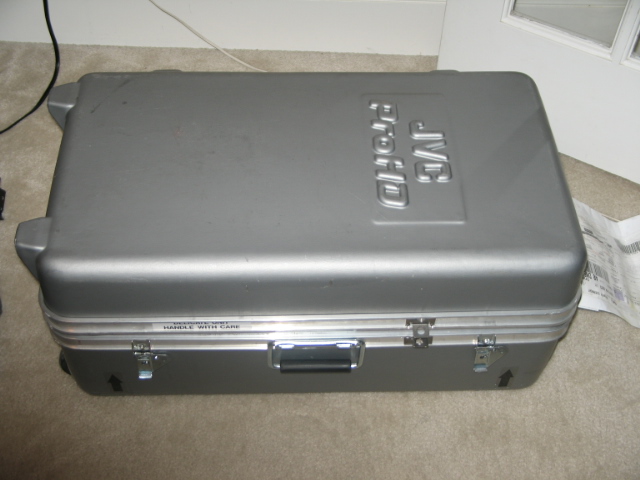

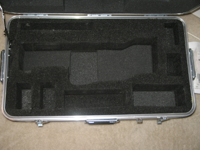

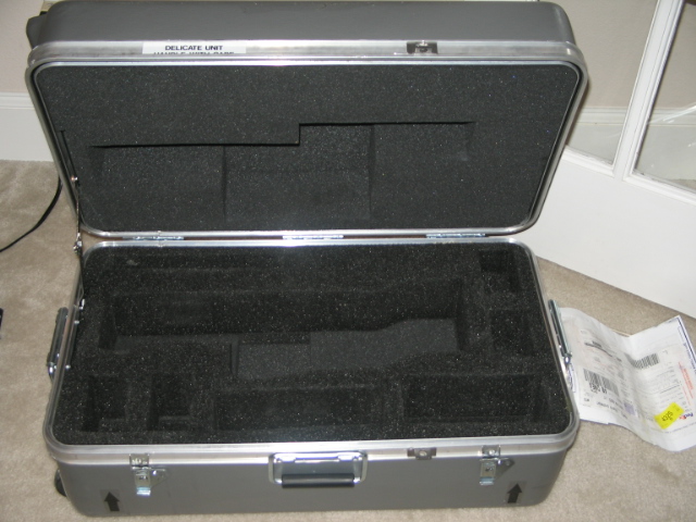

Jack, I have posted some pictures. The dimensions are:
Outside - 29.5" Long / 12.5" High / 17.5" Wide
Inside - 27" Long / 11" High / 15.5" Wide
Yes, it will hold the camera with the 13X, or other similar sized lens, attached. No, there is not room for two lenses. You can also hold an Anton Bauer or IDX battery, and the Anton Bauer charger. The IDX charger won't fit unless you cut out some of the foam. There are several other small pockets for cables, tapes, and even the DR-HD100 can fit. It's a well-made flight case, with wheels and a pull-out handle. I use it extensively as a carry case and a shipping case for my demo GY-HD110.
Regards, Carl

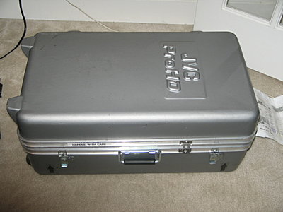

Here's a photo of the CB-100 loaded for bear.
For Simon -- the case is lockable. You have the freedom to put your own locks on it; you're not forced into a particular type of lock imposed by JVC. Add whatever lock you want. This is a big advantage if you have several cases; you can keep them all keyed alike. Or the same combination, etc.
