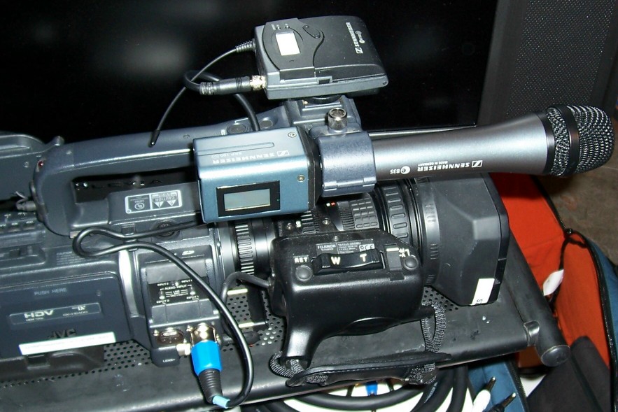

That's just it, why use the shoe? Use the stereo mic in the holder and eschew the stock mic to your case or bag. I guarantee the Rode NT4 is not heavier than a Senn e835 + skp100 like I had to use overseas when my shotgun mic bit the dust. The combo of the Senn e835 & skp100 didn't stop me in the least because of weight.
check it out in the pic.

At this point in this discussion, I'm lost.
The Sennheiser E835 + SK100 are almost 18 ounces. In addition, not stereo, not condenser... a handheld mic for an announcer.
The AT835ST is 3.6 ounces, and it is made for the use as outlined in the original post. The field is switchable and will give excellent sound for on camera use (which is not the way to record anyway, but for stereo ambience, I suppose it's fine.)
The Rode won't fit the camera holder, and it weighs 17 ounces. The original mic that caused the problems (VP88) was only 14 ounces.

Weren't you referring to weight? An NT4 doesn't weight as much as an e835 + SKP100....

The Rode NT4 weighs 16.9 ounces.
The e835 (11.64 ounces) + SKP100 (6.88 ounces) weighs 18.52 ounces.
The NT4 is 1.62 ounces less in weight.
The mic I suggested, the AT835ST (3.6 ounces), weighs 14.92 ounces less in weight.
And I think I've finished my responding to this thread, since I've given the weights three times, and judging from the original post and succeeding posts from both the original poster and others, I must assume the original post was a troll.

Jack,
All I'm saying is that the e835 setup wasn't a burden in the least so it's likely the NT4 wouldn't present any problems either.

Actually, I agree with you, but in this case both are heavier than the mic that was too heavy in the original post.
However, I also think the 1-1/8 inch barrel on the NT4 is too thick for the camera mount... and I think the exposed dual cartridges on the NT4 are not well-suited to on-camera, run-and-gun use... but anything is possible, and probably been done.
