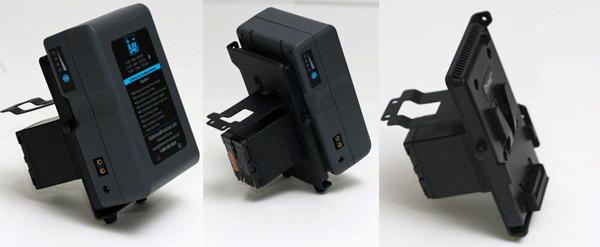

Hi Marc,
I am in a very similiar position regarding yourself. I am just in the process of buying the JVC GY-HD111E as well as additional gear.
I agree with your choice of batteries:
IDX, 2xEndura 7S batteries, 1xVL2Plus Charger, 1xA-E2HD100 batterybracket
Don't know what price you are paying for them but I am looking at buying from the US the following:
http://www.batteries4broadcast.com/hd100.htm
They are charging US $875.00 plus shipping.
This converts roughtly to around 700 Euros. For the price I haven't been able to find a better deal in Europe.
This is a 2 battery 2 channel charger system.
Have a look at the attached pic and let me know what you think.
Simon
