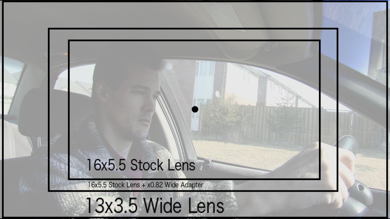

The 0.82x Wide converter works well for zoom through, and doesn't seem to degrade the image.
The converter effectively turns your 5.5mm lens into approximately a 4.5mm lens.
The adapter can also "live" on the lens and the hood slips right over it.
I've attached a field of view comparison of the stock lens with and without the converter, compared to the expensive wide angle 13x3.5 lens. This was based on a real world test, and not calculated, so the adapter doesn't appear as wide as you might think.

I would agree with Tim on his assessment. Once I put the WA converter on the lens, I've never once had the need to take it off. The stock lens is pretty long, even with the converter on there. I think it's a fair compromise for the price.
Still, I'm thinking more and more of the 3.5 lens to obtain the better glass and those nice high-end wide angle images that my clients tend to crave. It's either that or a new GY-HD200, now that its release is imminent.... What to do....

We also use the WA adapter and it stays on for most of our outdoor shots, however I remove it when shooting green screen, we found it did degrade the image a fractional amount. I could only tell the difference in a controlled studio environment where every pixel was scrutinized. It's good glass and still worth the money, more so considering the alternatives.
