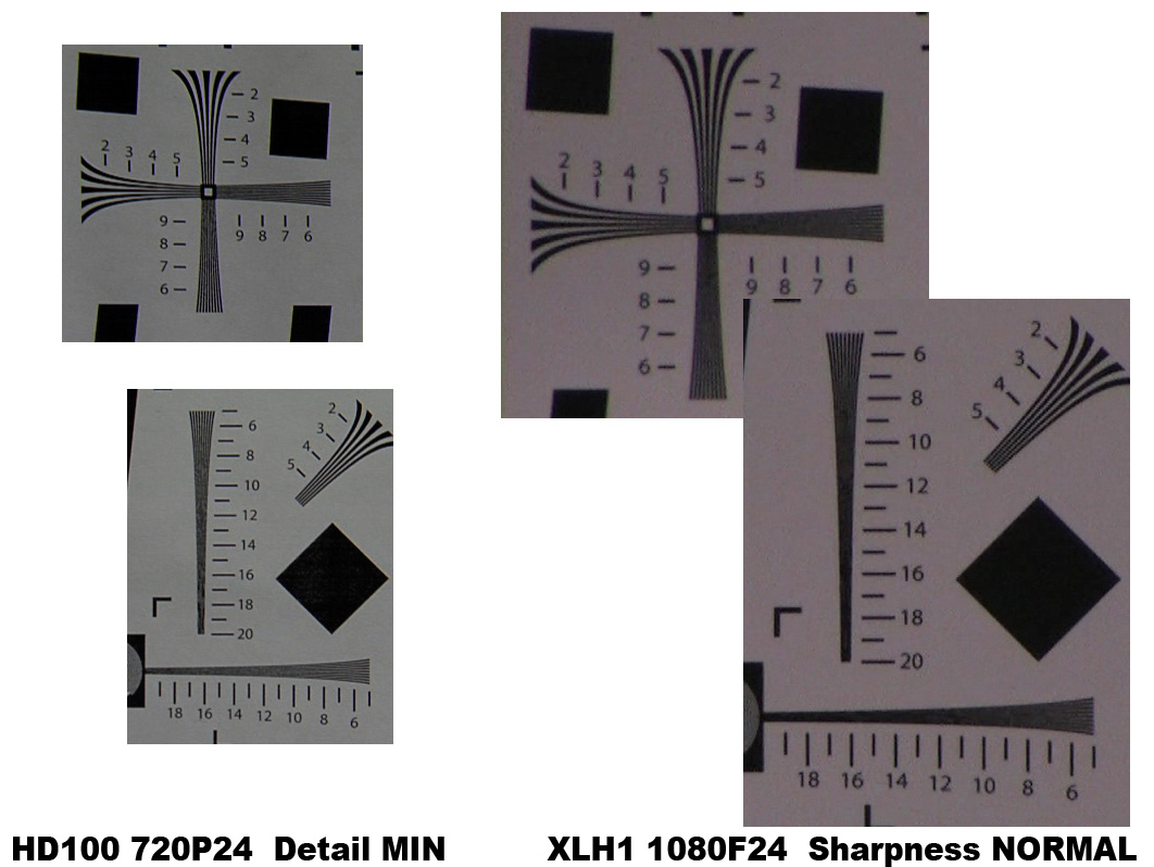

I had high hopes for the XLH1 when it was announced because of the SDI out and BNC connectors. I thought "they've upped the ante" for JVC.
I also owned a XL2 at the time and figured their 24 HDV mode would look just as good.
However, I then tested the Canon XLH1 in 24F mode next to the HD100 in 24P mode, and was disappointed in the results.
From a pure resolution standpoint the HD100 beat it hands down. My best guess is that the XLH1 scans every other line (540) when in "F" mode and then line-doubles to achieve 1080PsF. The horizontal resolution didn't seem to be as good as I would have expected either.
I'll post the lens chart comparisons.
From a user standpoint I wasn't crazy about the continuance of the XL form factor. I've used XL1 and XL2 extensively in the past and I had hoped Canon would have moved away from this form factor when they entered HDV. To each his own!
I also tested the two gamma curves and once again the HD100's knee and Cine curve allowed more dynamic range, and a more organic "film look."
The XL lens was not fun to work with. It was basically an update of Canon's earlier XL lenses, with backfocus issues and servo controlled optics that run on rails. When I bought my XL2, I bought the body only and then used Canon's manual 16x lens. As far as I know, Canon has still not released a manual XL HD lens - although with the resolution of the chip in 24F mode, the old 16x or 14x manual XL lenses will probably resolve sharp enough.
Originally Posted by Joseph Olesh
* gy-hd 110 and final cut pro??
FCP 5.1.2 is compatible with 720P24, 720P25, and 720P30 native HDV.
EDIT: As promised, I've attached a quick comparison of HD100 vs XLH1 resolution tests. The HD100 is set to Minimum detail level, and the XLH1 is on Normal Sharpness level - which seemed to match pretty closely.
This is a pixel for pixel comparison, so you will see the size difference based on 720P vs 1080i.
