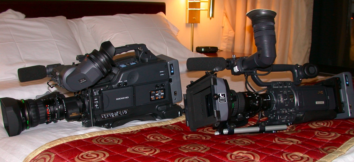

Hi Nate, Can you post a jpg of the XDCam next to somthing for a sense of scale? I was under the impression that it was not too much bigger than the JVCs, i know its about 12-14 lbs loaded with batt, disc etc.. but i wouldn't mind to see the scale of the camera, it would be cool if I could see a picture of an XD cam side by side with a HD100, XLH1....

Originally Posted by Brian Ladue
I know its about 12-14 lbs loaded with batt, disc etc..
Mmm, more like 18-20lbs, depending on the lens and batt. Mine's 19lbs. It's heavy enough your arm will complain if you have to hand carry it long enough.
Here's a pic from the Texas shootout earlier this year. In overall dimensions they are not too far off, but think of the XDCAM as being "really dense" weight wise for it's volume. The HD100 sits on your shoulder nicely, and doesn't bother you much. The XDCAM feels like putting a 20lb bag of dog food on your shoulder...you won't ever forget it's there.
19 lbs...... are you using a Hytron 140?, that thing is like 5.5 lbs...thats like sticking a Z1U Camera on the back! How does the AB Dionic 90s perform? they are like 1.7 lbs. I'm guessing that you can probably get about 4 hours out of one of them.
No, I'm using a very light battery, a 90wh lithium from Batteries4broadcast. I get 3-4 hours out of it.
It's my lens that adds so much, a Canon H9ax3.8IRS. Any of the good wide-angles weigh as much or more than the body. Or a 2/3" HD lens is the same or worse.
