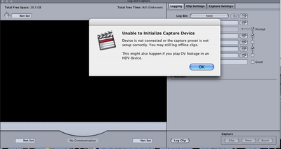

Can't see HD100 anymore after I changed Firewire HDV settings
my mac can't see HD100 anymore. Lumiere, FCP 5 and iMovie don't seem to recognize the camera. I am not sure whether its the camera's fault (its been fine up until now) or because I changed settings in Firewire HDV accorind to this thread: http://www.dvinfo.net/conf/showthread.php?t=75138
I doubt that settings prevent the computer from seeing the camera, especially that I only changed the settings in FCP. Anyhow, Lumiere and other programs can't seem to find the HD100.

These are the setting I have right now. Thanks
http://server6.theimagehosting.com/i...081&fullsize=1
If you click on the image it will take you to the next image showing settings and then to the next one. There are five images in all.

Also, I just noticed that when I connect the firewire cable to the camcorder my computer starts to emit noise. I don't know how to describe it - it's sort of high-pitch intermiettent signal. Sometimes if you turn a TV on (especially an old one) and turn the volume all the way down similar noise is present.
Could something have happened to the drivers? Maybe firewire output on the camera itself? Or the firewire input on the computer? Has anyone else had this problem? I am thinking of reinstalling the OS X from the scratch - horrible thought...
I need to digitize footage for tomorrow and this was really not what I needed right now.
