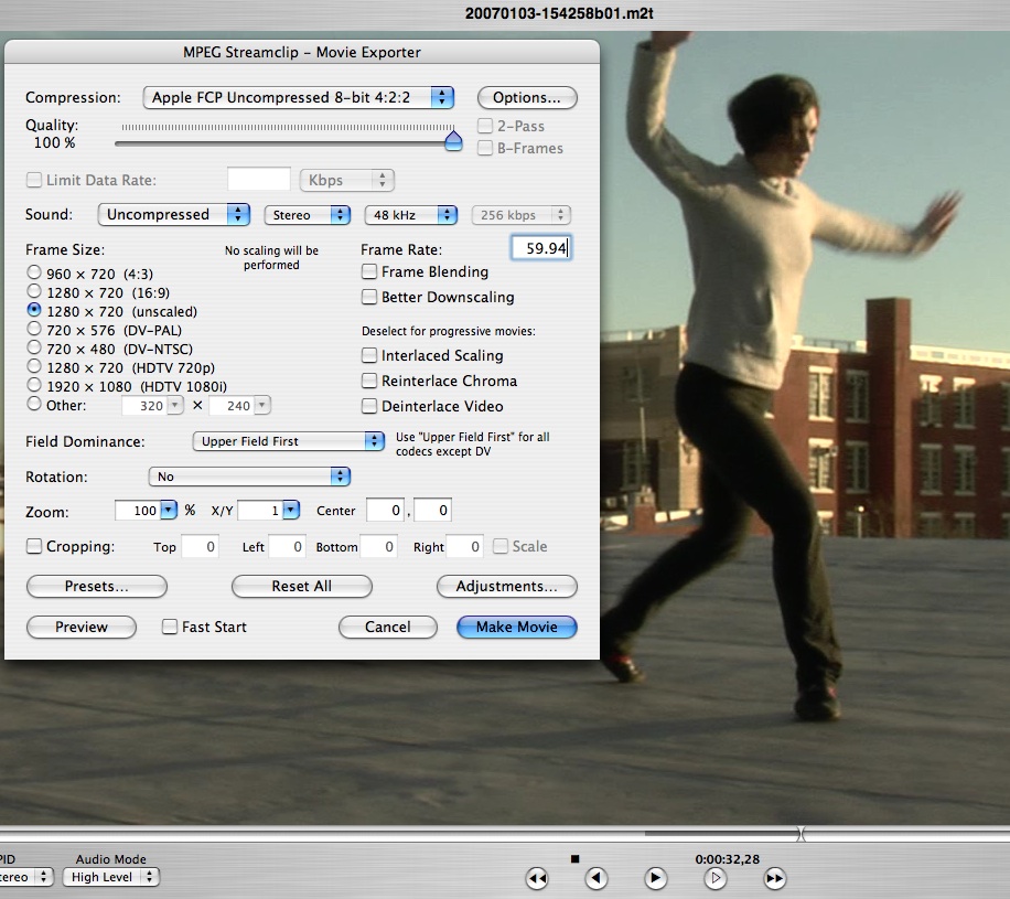

  3. Open the m2t file in MPEG StreamClip. Cinema Tools can only conform the frame rate on quicktime I-frame based codecs, so we must transcode the m2t to quicktime.
  4. Choose "Export to Quicktime" (⌘+E)
    Attachment 1714
  5. Set the compression to your desired I-frame based codec. I chose "FCP Uncompressed 8-bit 4:2:2" in this example, but if you would like to save hard drive space this method also works with Apple Intermediate Codec.
    I also selected "1280x720 (unscaled)" because this was already a 720P clip, but you can also use this feature in MPEG Streamclip to uprez your 480P60 or 576P50 files to 1280x720 (or 1920x1080 for that matter.)
    I also set the frame rate to 59.94, but you can leave it blank and the file should still default to its current frame rate.
    NOTE: It is important NOT to set the frame rate to 23.98 at this point. Doing so would create a 24P file that plays in realtime. This could be useful if you want to pull 24P out of a 60P file, but for our slow-motion purposes we will leave it at 60P.

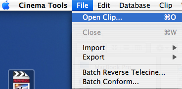

  6. Now Launch Cinema Tools and open (⌘+O) your new Quicktime file.
    NOTE:Hit Cancel if you are asked to open a Cinema Tools database during launch. This is normal.

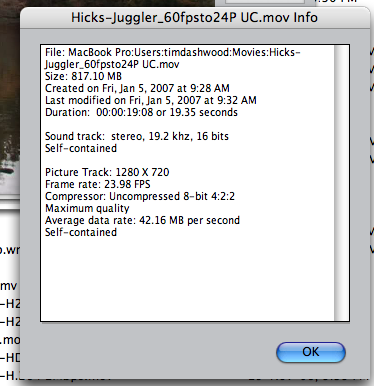

  7. Click the Conform button and set the frame rate to 23.98 (or 29.97 if you plan to work in 30P.)
    Attachment 1711
  8. Cinema Tools will instantly modify the quicktime file by simply telling it to play at the new frame rate. You will notice that the sample rate of your audio has been lowered by the same amount to maintain sync, so 48khz becomes 19.2khz.

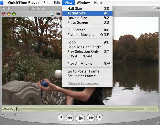

    You can now open the quicktime file and it plays in slowmotion. Cinema Tools has a little quirk that modifies the display size preference to 50%. Simply change this in the Quicktime Pro player to Actual size (⌘+1.)
    You can skip this step if you are going straight into FCP.
