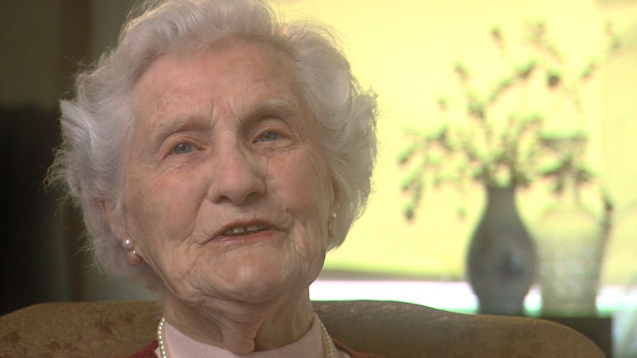

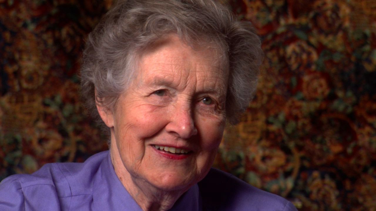

I've just uploaded a couple of JPG's from two interviews. One has what looks like CA and one without. I have no idea if this will work as I've never tried this before. It's not showing up in the preview window- let's see if it shows up in the post. If it does, the difference I see is that the clips with the light background shows the CA whereas the clip w/ the subdued lighting in the background doesn't. It may be a function of avoiding too much white or blowing out your whites. Does that make sense?

absolutely. i've noticed that CA appears much worse when overexposed. I took some footage of the recent snowstorm we had. The footage showed very noticeable green/magenta blooming at the interface between the snow(light) and the trees(dark). As you can imagine, the exposure range was probably more than 8 stops, so the snow was blown out.
